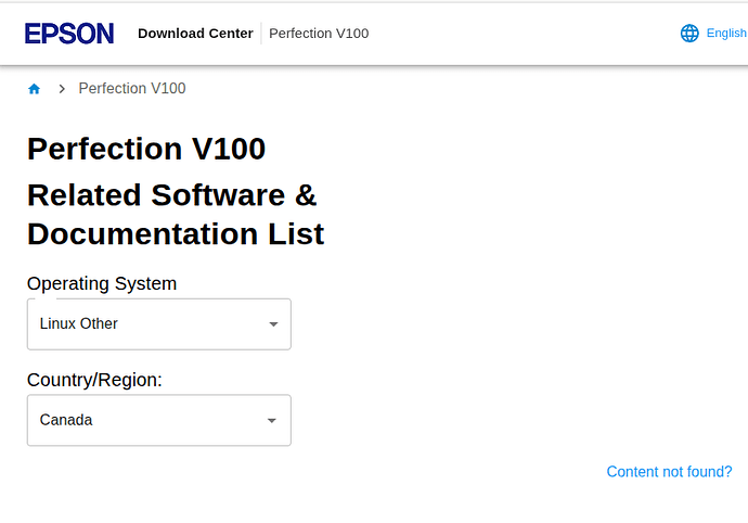

PROBLEM: Finding the driver from the Epson website now seems impossible:
So it’s possible the latest is not v2.30.4 anymore and there is no way that I could confirm that.
