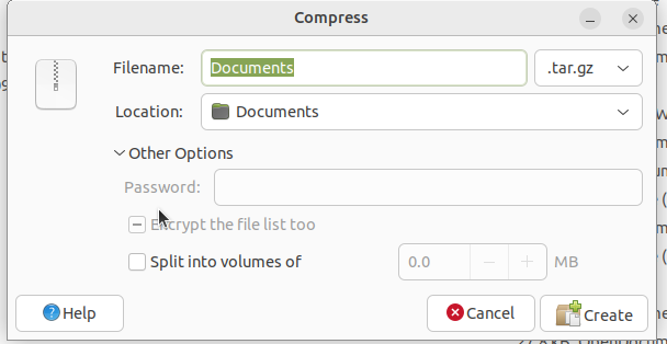

When I try to add a password or the other choices, there is no response.
Caja is pretty nifty and has features that Thunar does not have.
Change the extension to zip or 7z instead of .tar.gz and the password option will show up.

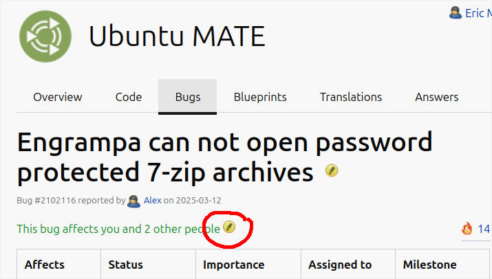

Yes, half a year ago:
https://bugs.launchpad.net/ubuntu-mate/+bug/2102116
It may be a great help if all of you clicked the "me too" button on that bug.
For those who are looking for the "Me Too" button, I circled it in the below image:
