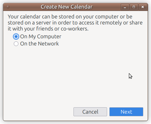

That’s interesting Claudio. I looked into the Thunderbird option but it requires cloud and I like to have all my appointments and tasks locally on my computer. That was why I had set up Gnome calendar and Korganizer. Evolution seems to allow you to store everything locally although it seems to require you to sync with an email. Of course it would be great if events on the Gnome calendar and tasks on the Korganizer would generate pop ups!
I am afraid there is some confusion and that is not the only use case. Thunderbird's calendar does not require cloud access. Look:

Thanks a lot ugnvs, that’s great that you don’t have to have them on the cloud! I am a bit cautious about having my tasks and calendar tied to my email account but it sounds like you have to use an email account to use Thunderbird. That was why I had liked the standalone Gnome calendar and Korganizer. But it sounds like Thunderbird or Evolution will be the only options, requiring an email account to be associated with them. And thanks a lot for trying to generate the pop up notifications on MATE Philippe! Perhaps some day it will be possible to have pop up notifications on MATE, like with Plasma - which does give pop up notifications…

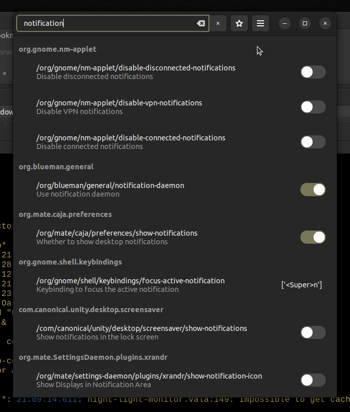

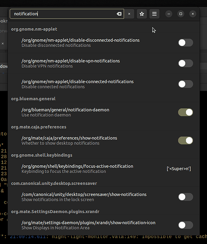

@DaveHighland,
shouldn't there be a configurable parameter available from dconf-editor, for turning on/off the pop-up notifications for that application, similar to the below?
