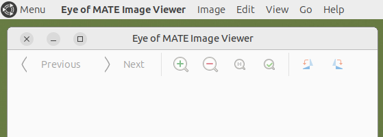

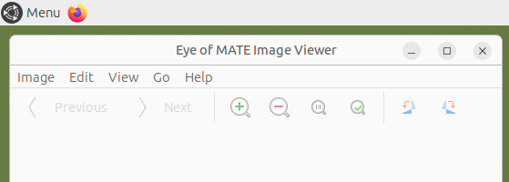

The 'Contemporary' layout is configured to use the global menu, the 'Familiar' is not.
See the screenshots:
What you encountered was not a mystery, just some bug with your global menu. When you switched back to the 'Familiar' layout, the menus returned back to their place. That's what @DaveHighland was trying to explain to you using the 'Cupertino' layout as an example.
