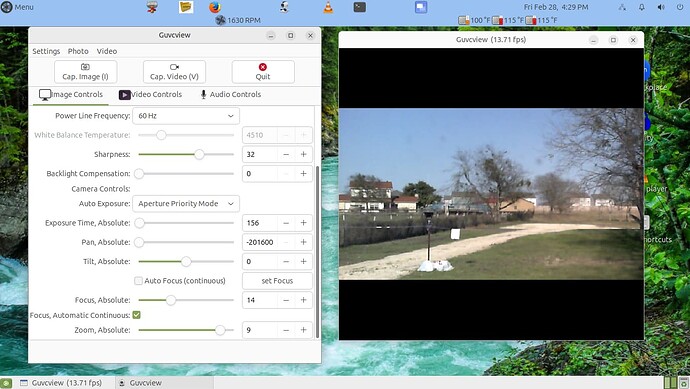

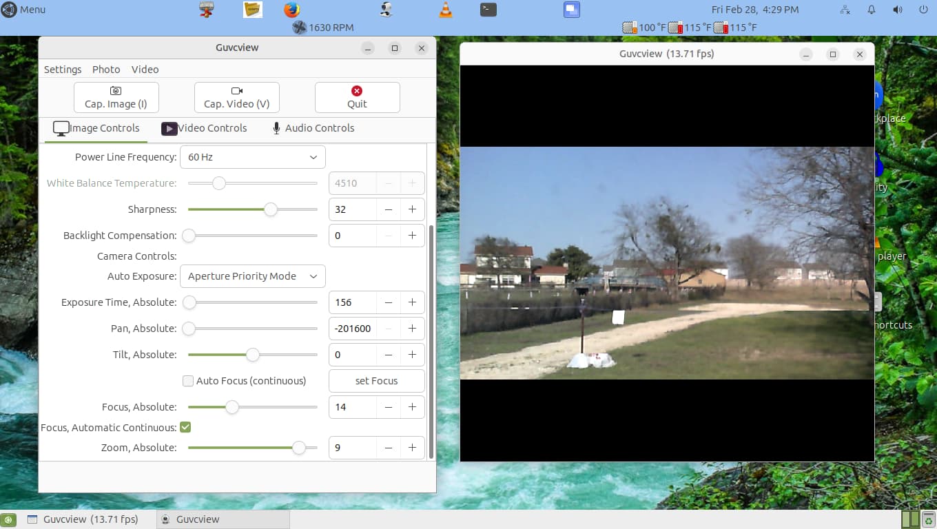

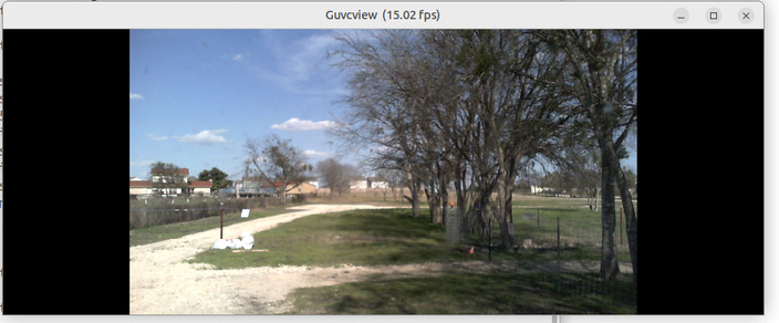

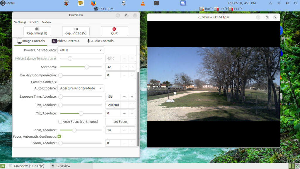

Is this webcam picture clear?
I am using guvcview and am very happy with it.
I have 2 pictures.
One that is "unzoomed" and a "zoomed picture".
Do they look clear to you?

I tried this.
I need more light than ever to see more clearly.
My glasses correct my vision to 20\20.
The back room light kinda washes out that room. :slight_smile:

That image is showing 1024x578 resolution.

Don't know if this is possible, but can your video camera change zoom magnification on the fly while recording?
The camera itself offers 4x "digital zoom". Would it be beneficial/practical to alternate zoom setting in the same recording, namely
  • zoom 1x for 2 sec,
  • zoom 4x for 2 sec,
  • zoom 1x for 2 sec, endlessly ...
I am talking of doing this programmatically using your recording command, of course. "guvcview" itself does not offer options for that on the command line.
Just a thought! :slight_smile:
