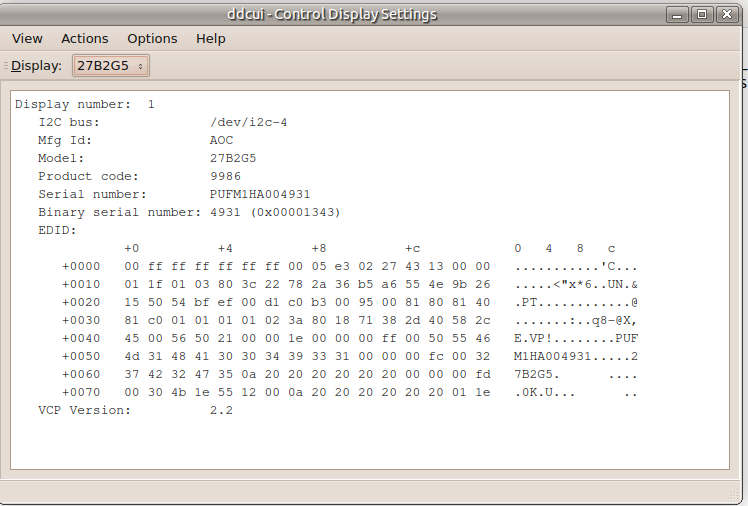

Install ddcui and tell us if you change brightness after.
screenshot
Ok in that ddcui app try and click "view" option - I think there you should have option to switch to "Features View" - there when you open it you should be able to see that same exact options that @tkn has screenshot-ed earlier today!

how to change gains red green blue?
i try to change them with ddcui but i can't

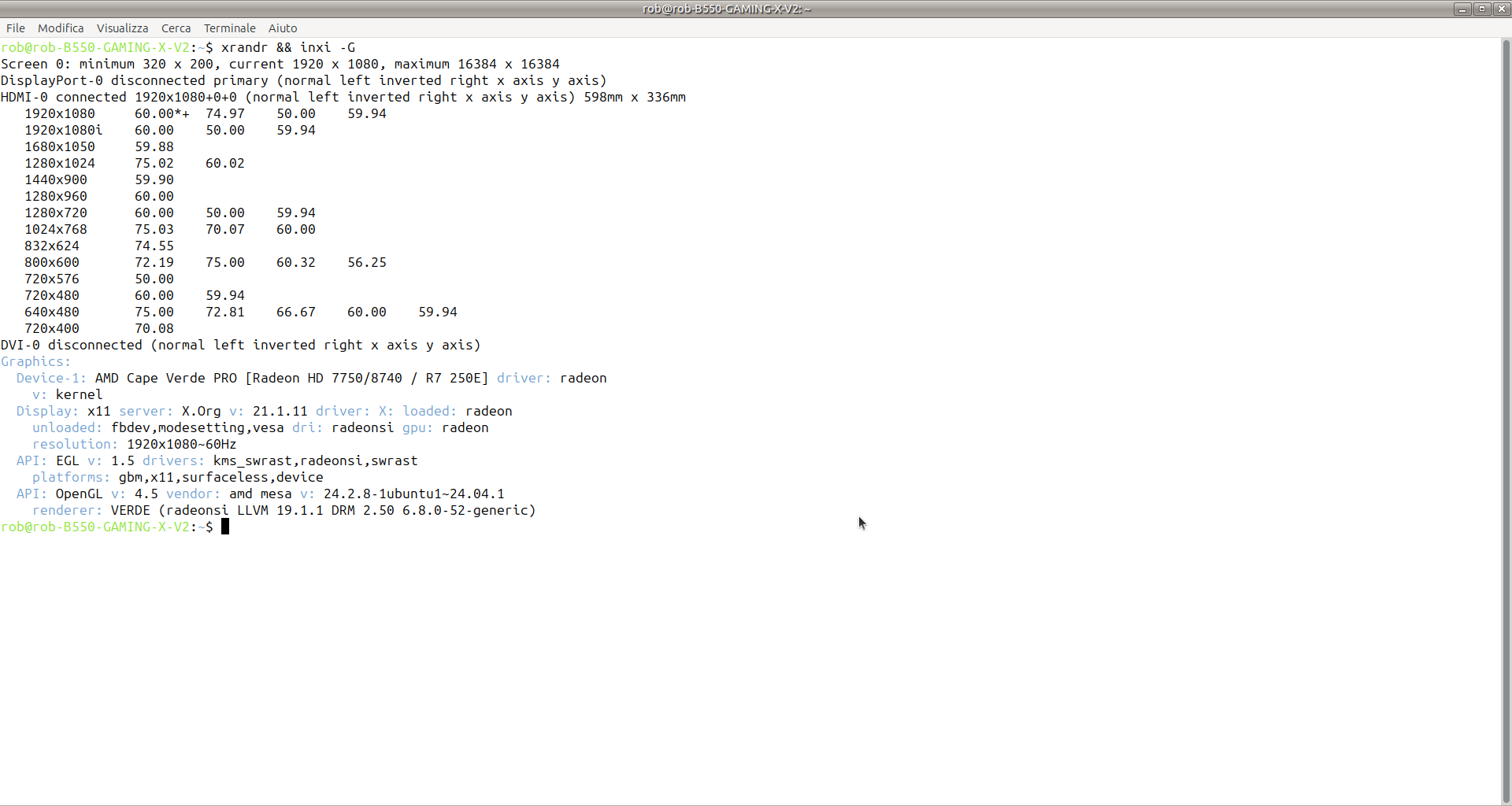

Can you show us the return of:
xrandr && inxi -G
https://www.ddcutil.com/ddcui_main/
On this link you may find some instructions and answers that might be of help to you - I don't know how to solve your problem myself sorry
