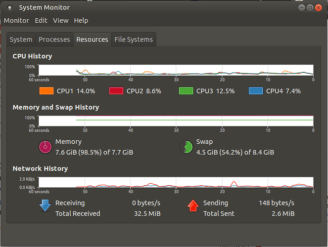

Found a screenshot of the first occurance:

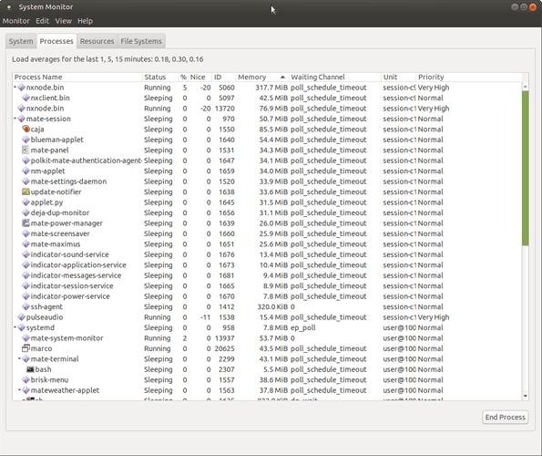

You can sort in the second tab, (processes) by the memory column to see the top offenders.
my screenshot (if it helps)
