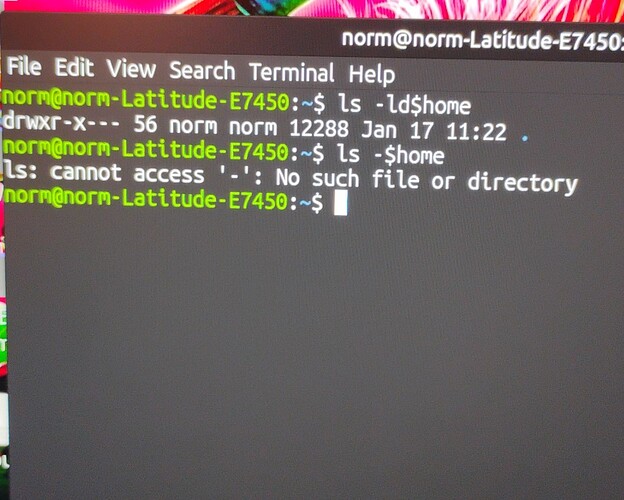

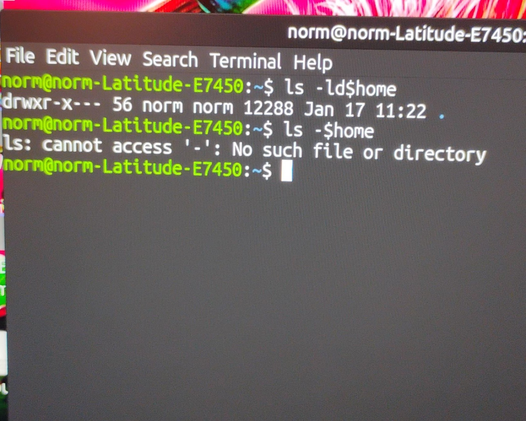

Can you run the following and share the output?
ls -ld $HOME
ls -l $HOME
Output for both commands will have to be attached with a photo.
norm norm would an indication it is not an ownership issue.

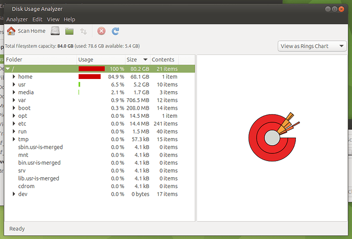

You can try a command to get a feeling about what directories are taking up the most space.
The following command lists the 20 directories that take up the most space, up to a maximum depth of 6 and sorts the listing so that the directory that takes up the most space appears first . (The / directory will probably always appear first, since it logically contains all the other directories):
sudo du -h --max-depth=6 / 2>/dev/null | sort -hr | head -n 20
MATE Disk Usage Analyzer might be the most visual way to find out what's taking up space. It could be something unexpected like a crash dump (the contents of a program's memory when it crashed).
In this case, oopsie, I ran a fallocate command and filled up my /home :upside_down_face: - It is a bit limited in that it doesn't show files, only folders when you expand the tree.
If you can't open this tool via the menu, you can run it from the terminal:
mate-disk-usage-analyzer
I think it's installed as part of the MATE desktop, but if it's not installed... uh, maybe not.

My /tmp directory was loaded with over 200GB of files.I'd love to know how that happened but in the end opening Caja as root and deleting the contents of /temp and then running clean/autoclean/ as root did the trick.
I wish I could mark everyone's replies as the solution as they all pointed me in the right direction but running mate-disk-usage-analyzer as suggested by @lah7 showed me what I needed to see,it just took a REALLY LONG TIME to load!
