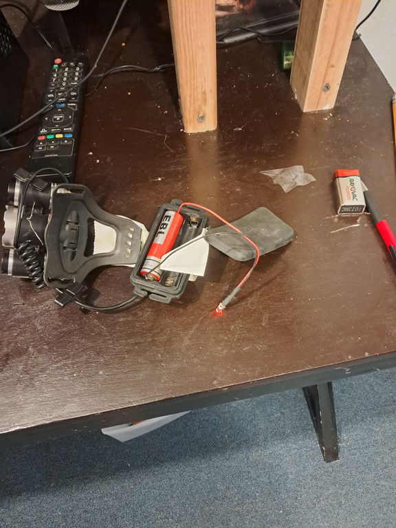

Voltage source to power a blinking red LED

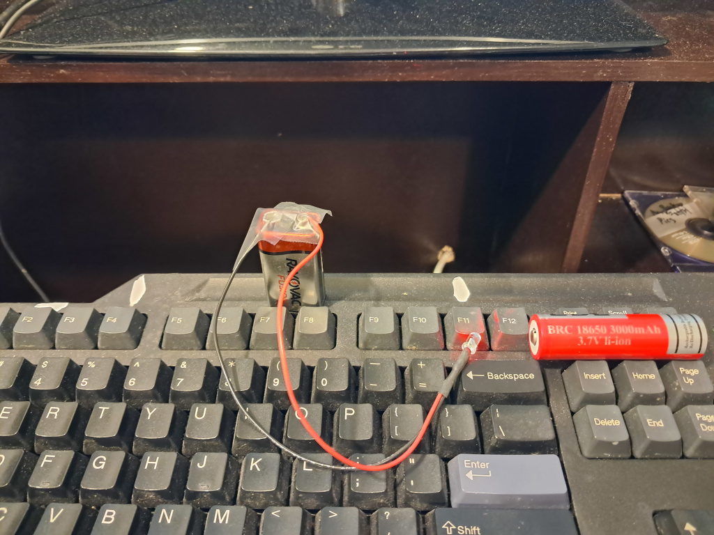

This shows that the 9 Volt D.C. battery works.
The LiIon battery at 3.7 V D.C. does not.

Flashing LED's typically run on 3V-5V DC.
It seems that your model needs just a little bit more than 4V DC or your Li-ion battery is flat. :innocent:
Could you check with a voltmeter if the LED is actually getting something between 3 and 5V DC from the Li-ion battery ?
By the way, the reason it doesn't blow up on your 9V DC test is because of the internal resistance of the battery.
If you have the make and model of the LED on hand, I could give you a definite answer.
Without it, it is just an educated guess.
Based on that, I would say that it might actually run without problem on 5V DC.

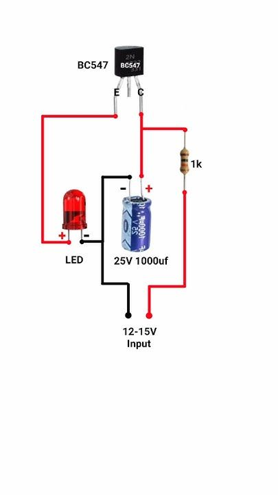

Here's a basic RC circuit.

It works with another LiIon battery.
I was planning on taking a part of a USB cable, but if there is an easier way,
I am game.
