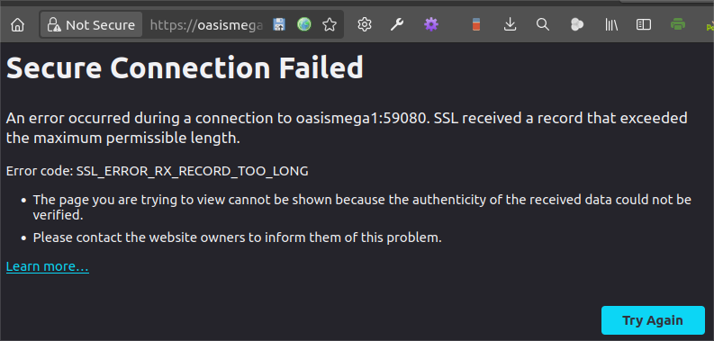

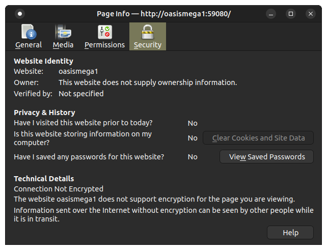

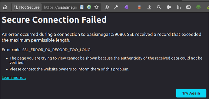

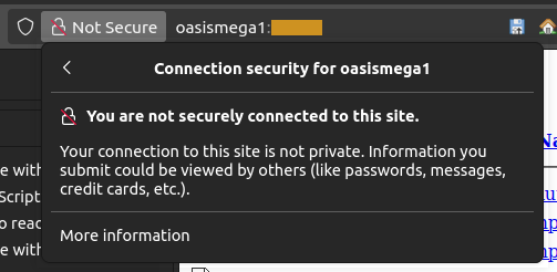

Also of note, using "localhost", there is no "security" issue.
However, using ${HOSTNAME}, Firefox is reporting a security issue:
and further details offered:
Correction: I had omitted the required "s" for https, so there is no discrepancy in behaviour between the use of localhost or ${HOSTNAME}, but I am still getting a report of "not secure", likely because I did not personally configure any security. :slight_smile:
( === END of "suppressed" posting === )
