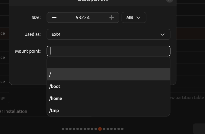

I am encountering a serious accessibility problem with the Ubuntu installer in Ubuntu 25.10 (and likely 24.10) when using the Orca screen reader.
Description of the Issue
When using the new Flutter-based Ubuntu installer with Orca enabled, many of the dropdown menus are not read aloud at all in the manual/custom disk partitioning step. For example:
  • Filesystem type selector (ext4, xfs, etc.)
  • Mount point selector (/ , /home, swap, etc.)
  • Size unit selector (MB, GB, etc.)
  • Disk selection dropdowns
Orca does not announce the current value, nor the list of options, and does not speak anything while navigating through these controls. This prevents blind or visually impaired users from safely and independently performing manual partitioning during installation, making this part of the installer effectively unusable.

I wanted to share an update on this issue and the steps I’ve taken since opening this topic.
I have now confirmed that the problem is still present in Ubuntu 26.04 (Resolute) daily build. When using the Flutter-based Ubuntu installer with Orca enabled, dropdown menus (especially during manual/custom disk partitioning) are not readable. Orca announces only the word β€œalert” instead of the control name or selected value, which makes manual partitioning unusable for blind users.
