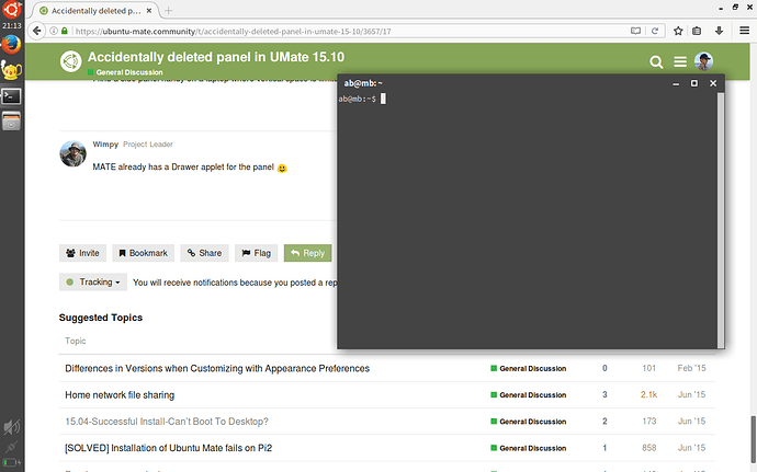

Here is my panel:
I'm all about the vertical space :wink:
I have not found this drawer applet option you mention.
