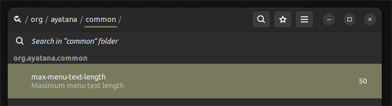

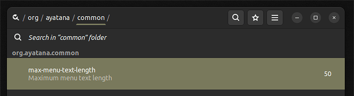

After reviewing this article, I have to say that I am sitting on the fence, because I would rather not have bloat, but as I said elsewhere, we either let ourselves be carried away with the "currents" or we may drown from the attempt of staying put in the middle of the "onslaught". Very tough call! :frowning:
In case it is relevant as to the point of "breakdown", I am on UM 22.04.5 and the dconf-editor is showing with proper dark theme. So, if yours is forced to light at UM 24.04, then that is the definitely the transition point regarding "backward-compatibility" of GNOME apps, unless there was a Yaru theme "architecture tweak", which we don't know of.
