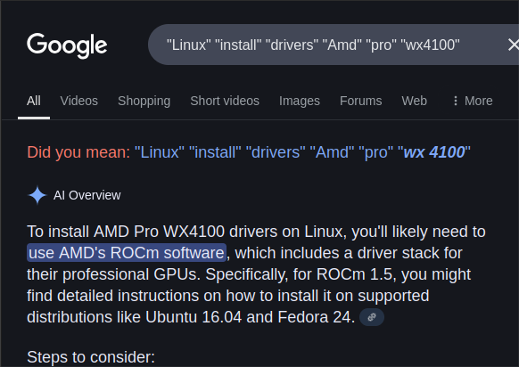

Also note that this last URL appears to be the recommended route according to Google's AI assistant:

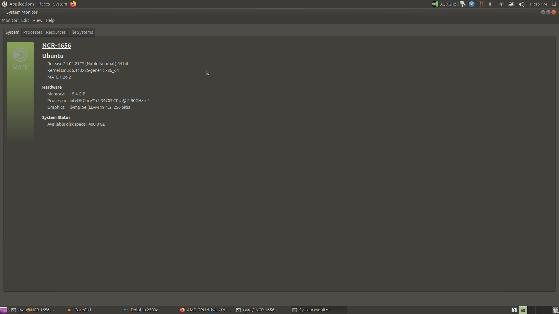

your right i installed the drivers but the gpu no longer shows up after installing the drivers sadly.

This helps alot how would i set the dedicated gpu as my default gpu because when i try to use open gpu with dolphin emulator i cant select my dedicated gpu but for vulkan it allows me to and when i put my games in full screen at 720p my frames go down for no reason and when i put it in a small window with the same resolution i get my 60 fps.
In the listing that @Philippe showed ,you see a line with dri: crocus which means that your inteldriver tries to do the 3D-acceleration instead of the AMDdriver.
You'll probably have to either blacklist or disable the intel-driver.
However, I don't have the experience to guide you there.
