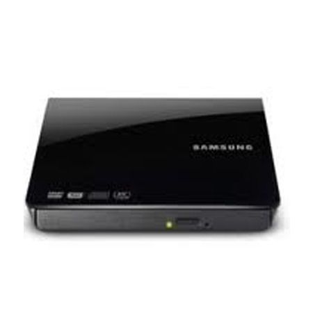

I have an external DVD-burner (which also gets its power from USB) and it is the DVD-burner that turned out to be the one with the longest lifespan of any burner I had. :slight_smile:
it's this one:
