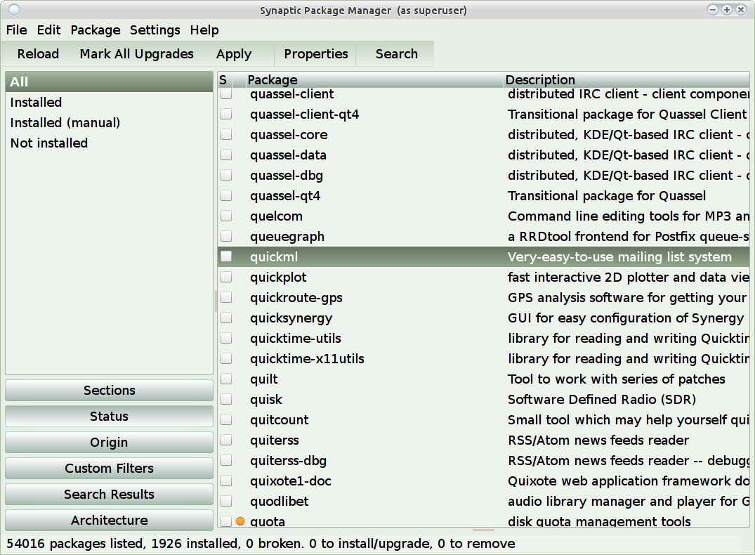

You could install synaptic and then you will see that the quickly no longer exist.
sudo apt install synaptic
The second package indeed does not exist and you can always check from the command line:
david@ThinkPad-T400:~$ apt-cache policy python-pygame quickly
python-pygame:
  Installiert:           (keine)
  Installationskandidat: 1.9.1release+dfsg-10
  Versionstabelle:
     1.9.1release+dfsg-10 500
        500 http://de.archive.ubuntu.com/ubuntu xenial/universe amd64 Packages
N: Paket quickly kann nicht gefunden werden.
