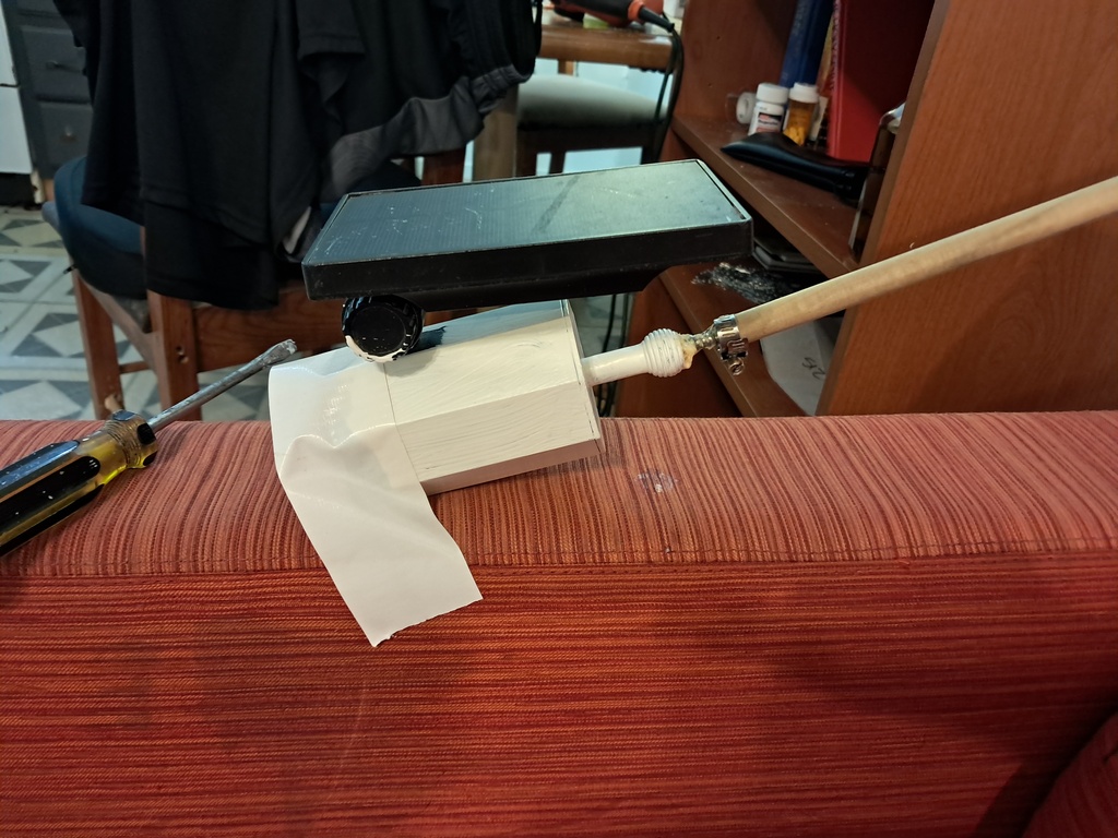

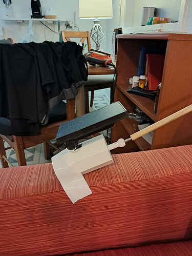

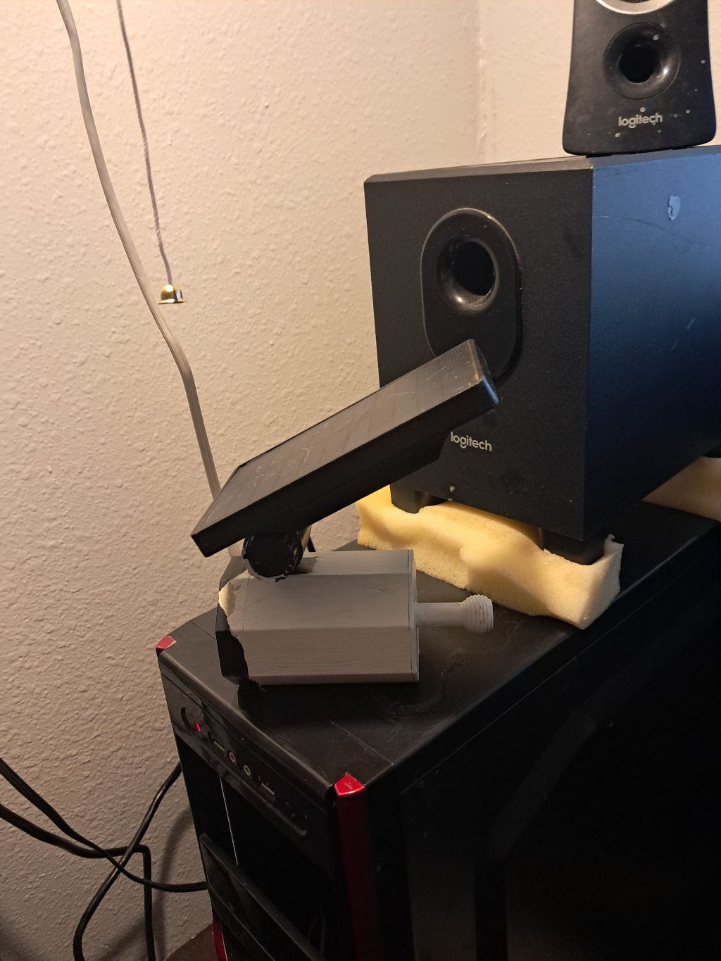

It helped. Here is what I so far.
The original Gorilla glue is best.
It requires a small amount of water to speed the setting of the glue.
I sometimes use spit.
The second picture is letting the glue set overnight.
if that ball shaft is made of plastic, I think you should seriously consider bying a pipe clamp and tighten that to avoid having that ball crack and your light falling on the ground, rocks or concrete!
Make sure you have the spirals all the way around, not just partial, because those will give some "gripping" to prevent the clamp from sliding off the ball. Once the clamp is tight, that will reinforce the shaft and minimize cracking from weight load stress on the weakened shaft that you put the screw into.

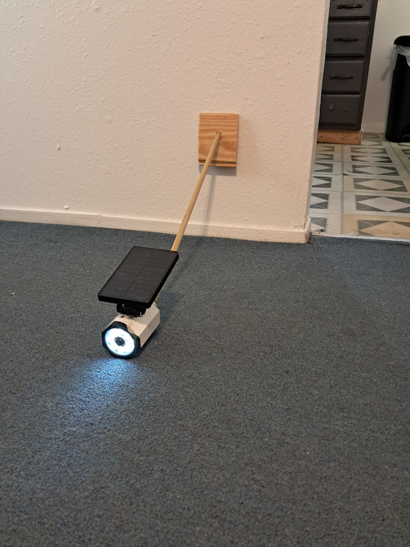

Like this ?
Thanks for the idea.
We frequently get winds up to 35 m.p.h.
Actually, on both the ball and the dowel.

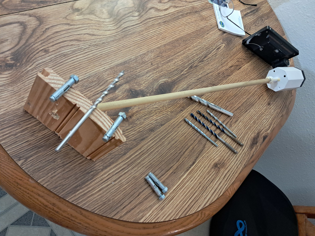

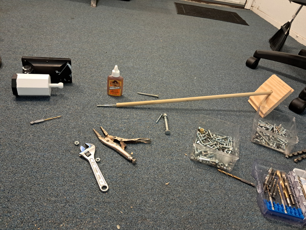

I think I am ready to mount this.
I will be painting it white.
And use wood glue and a a 'mini-dowel" to go thru the larger dowel into
the wood mounting plate.

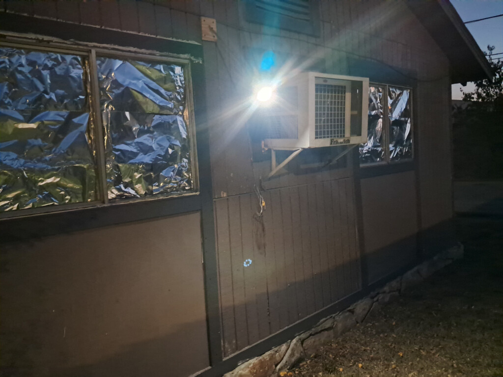

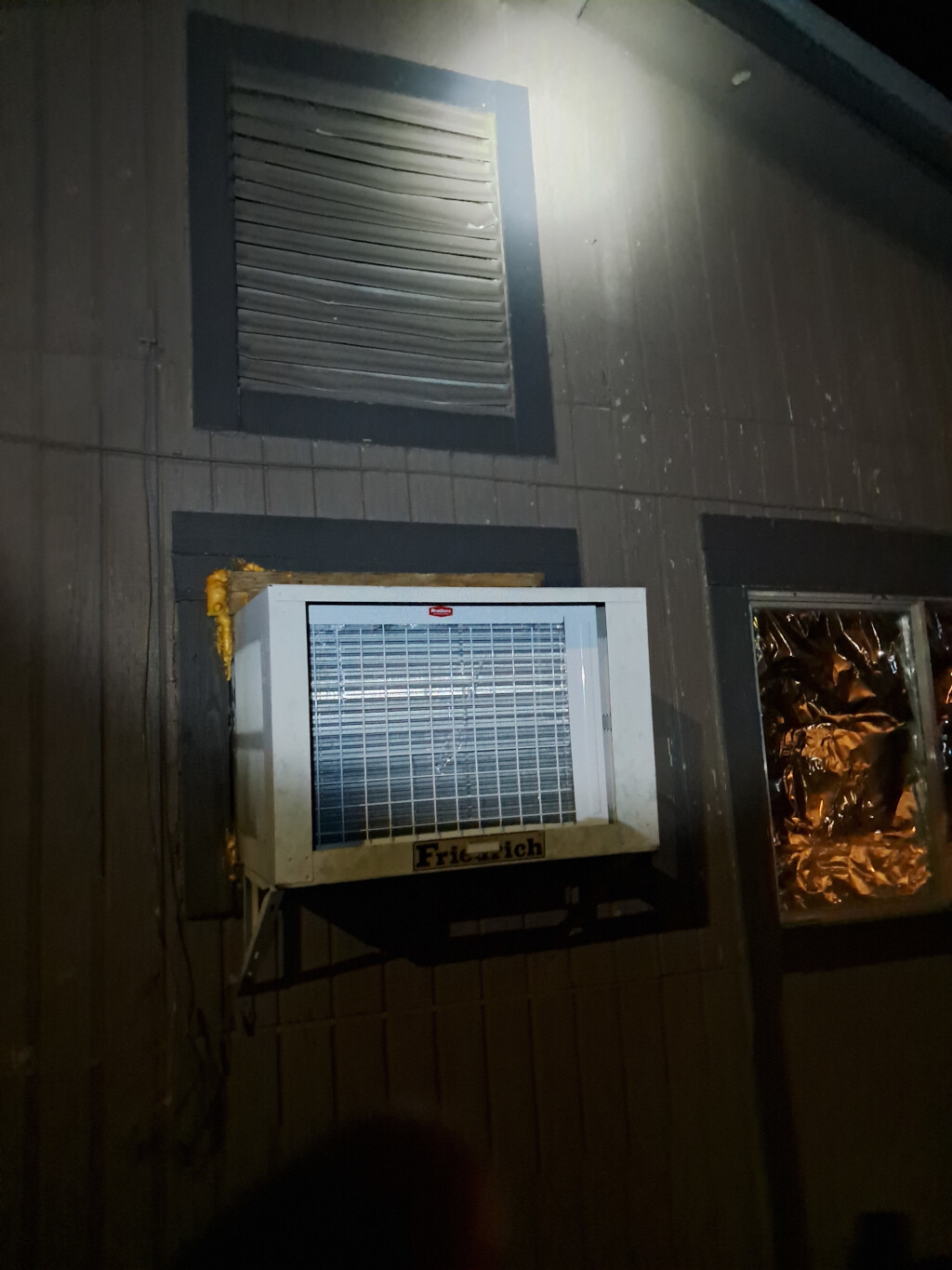

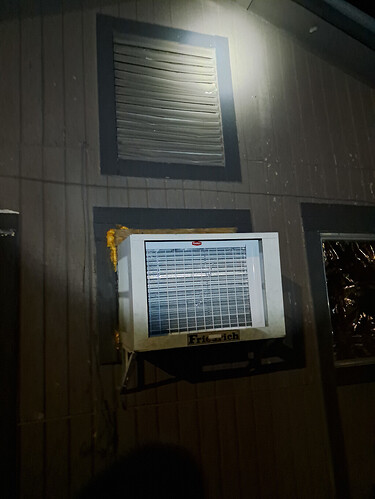

Here is where I will mount it.
It gets really dark out here. No city lights.
I will not need the masonry screws. I think some self-drilling
zinc anchor screws will do nicely.
Any ideas on where to mount it?
My finished motion detector light.
