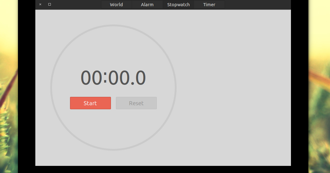

I've installed Xenial on my computer and enabled compton, but now and then I get really annoying big shadows.
Does anyone have solution for this?
I use the recommended nvidia drivers.

Thanks @IvCHo the borders are now better, but I started compton from mate-tweak. The solution given by webupd8.org actually worked fine
mkdir -p ~/.config/gtk-3.0
pluma ~/.config/gtk-3.0/gtk.css
then add the following:
.window-frame {
box-shadow: none;
margin: 1px;
Result:
The huge shadows are gone
