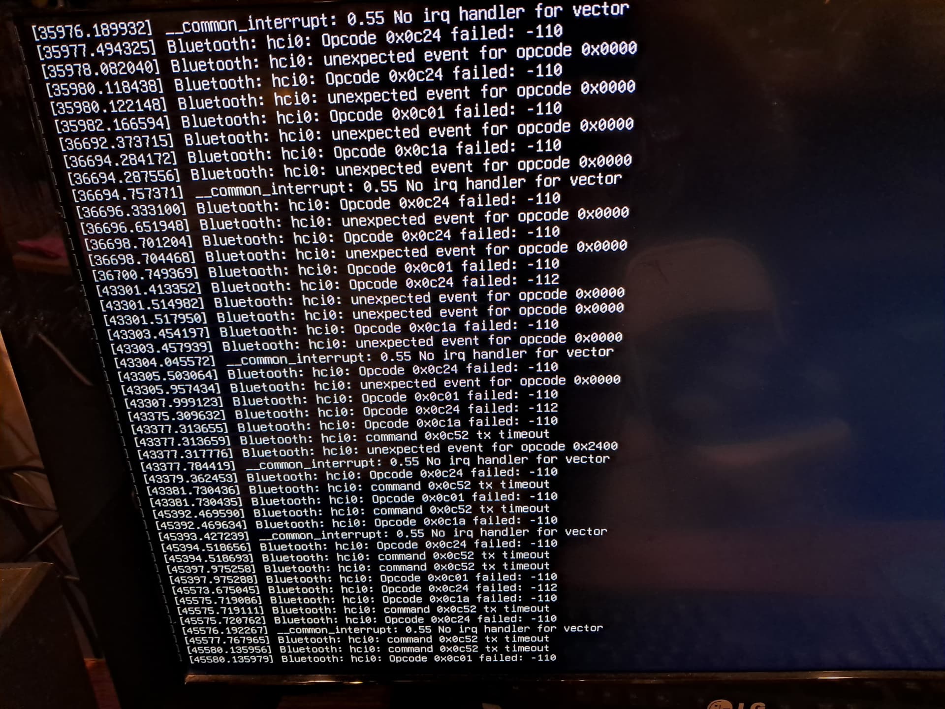

Bluetooth error causing computer to suspend
Bluetooth errors caused my computer to suspend. One time so far.
I use my cell phone USB tethering mode to share the phones internet connection.
On the Connections screen, these are set on.
Wi_Fi and Bluetooth
Can you point me in the direction to diagnose this?
For what it's worth on the internet I found that those errors may be one of the four listed:
  • The Bluetooth device is not properly initialized.
  • Hardware failure or a loose connection (if using a USB Bluetooth adapter).
  • A kernel issue or missing firmware.
  • Power-saving mode interfering with Bluetooth.
hci0 refers to your Bluetooth controller.
Opcode 0x0c24 corresponds to the Set Controller to Host Flow Control command in the Bluetooth HCI specification.
The error code -110 (ETIMEDOUT) means a timeout occurred—likely because the Bluetooth adapter did not respond.
I'd try to ether restart bluetooth:
sudo systemctl restart bluetooth
Reset bluetooth module (i believe it's this code):
sudo rmmod btusb
sudo modprobe btusb
Check if firmware is missing:
dmesg | grep -i firmware
Disable power-saving for Bluetooth:
echo 'options btusb enable_autosuspend=n' | sudo tee /etc/modprobe.d/btusb.conf
sudo update-initramfs -u
Or the solution may be to:
  • Restart the Bluetooth service.
  • Reinstall the Bluetooth firmware and drivers:
sudo apt reinstall linux-firmware
Hope something of the listed instructions help you, do let us know how the progress is going
Thanks for the detailed response .
I do not think I am using Bluetooth anymore.
I bought a Bluetooth dongle for use with my Amazon Echo which I no longer use.
And I use a direct cable from my cell phone to my computer.
I am going to do an "experiment."
Shut down my computer and remove the Bluetooth dongle and then see what happens.
Hi, @fixit7 :slight_smile:
You wrote:
To supplement @Alarik 's great response / reply - and considering that you believe that you don't use Bluetooth anymore - you can stop the "bluetooth" service and disable the automatic start of that service at boot, by running the following command:
sudo systemctl disable --now bluetooth
Thanks ricmarques.
I can do that.
Taking the dongle off solved the problem, but using your idea, I can just leave it plugged in for future use.
It worked perfect. :slight_smile:
