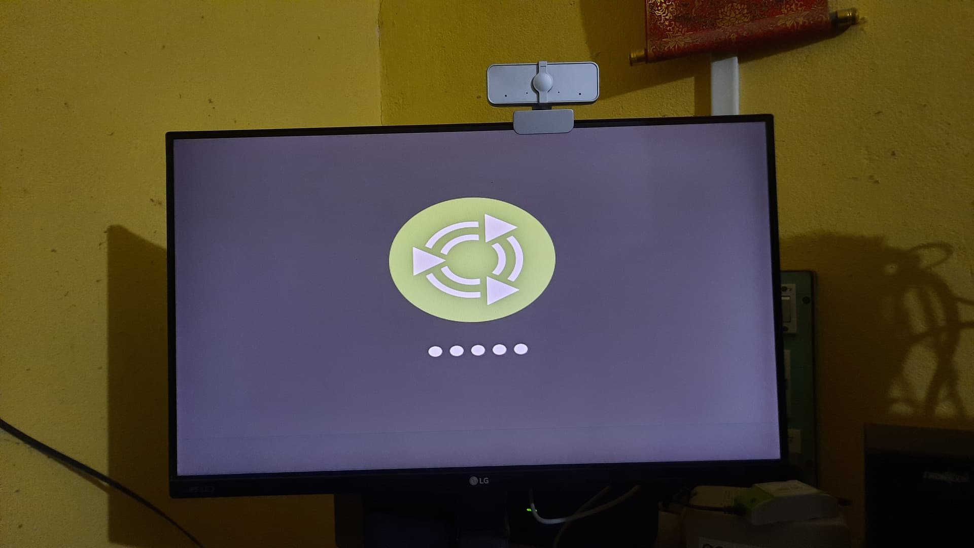

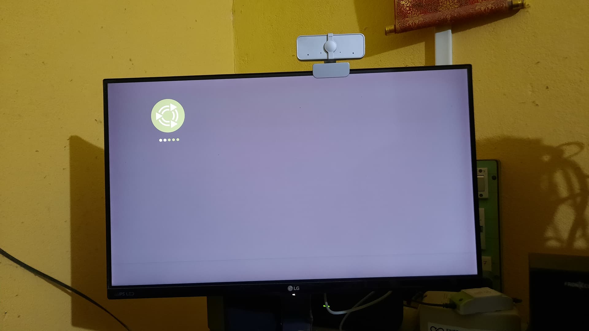

I have installed 24.04 on my desktop. The ubuntu mate logo which is shown at start up splash screen suddenly changing it's position from center of screen to left upper side of screen. Also the resolution and size of mate-logo is changing during this process. (Image uploaded ). How can I get rid of this problem?

Tried everything you suggested but result remains same. I think boot splash screen some how could not load the graphics driver (intel hd graphics) first time. After few second screen gets black and when on (after 2/4 seconds) the logo moved to left upper side with higher resolution.

I did a fresh install of Ubuntu MATE 24.10 on a Levovo ThinkPad Yoga and saw the same boot sequence: The original splash screen has a large centered logo with five "marching dots" but then further into the boot sequence, the logo shrinks to the upper left quadrant, still with the five "marching dots." However, when the desktop appears, everything looks as it should. My Displays / Monitor Preferences shows the resolution is 1366 x 768 and the scaling is set to "auto." 1366 x 768 is the native resolution of its 11.6-inch screen, so the startup is the same as yours, but somehow my resolution and scaling is auto adjusted during the boot process.
Not a solution, but it looks like
- System detects, chooses and sets low resolution and loads/generates appropriate pixmap.
- System detects, chooses and sets proper higher resolution and does not reload/regenerate pixmap.
For me it is not a 'problem' unless it becomes one
Just see it funny but understand it can be annoying for some
It doesn't impact computer use after boot.
