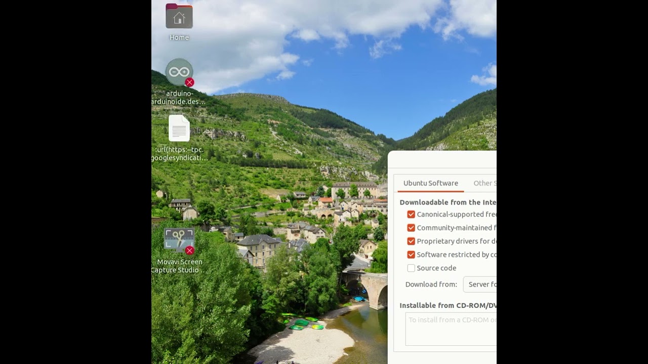

So I used the command-line to move a PDF out of its folder and onto the desktop, when all of a sudden all four of my desktop icons began to blink on and off, on and off, as if trying to say, "Danger! Danger!" or "Help Me!"
What this actually indicates, I have no idea, having never seen such a thing before.

Is your Ubuntu MATE 22.04 LTS ("Jammy Jellyfish") installation a fresh install or an upgrade from an earlier Ubuntu MATE version? If it is an upgrade, from what Ubuntu MATE version did you do the upgrade to 22.04? I'm asking because I've found the following question in the "Ask Ubuntu" web site, posted on 9th August 2022, where someone with the nickname "raddevus" (User raddevus - Ask Ubuntu) tried to upgrade from Ubuntu 21.04 directly to Ubuntu 22.04 (that direct upgrade path from 21.04 to 22.04 without upgrading first to 21.10 is not supported, although the user says that it was "Software Updater" that offered that direct upgrade path) and that user got the same problem of desktop icons flashing / blinking:
