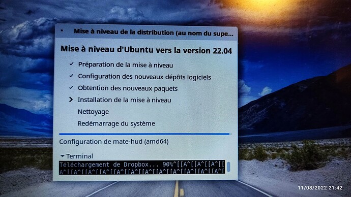

Point release 1 of 22.04 is available today and allow us to upgrade 20.04 to 22.04. While upgrade from 20.04 to 22.04.1 with the standard process, the caja-dropbox blocks the whole process. Yes, I used dropbox and the upgrade is stuck because of caja-dropbox. The process is stuck while download the caja-dropbox, at 90%. It stuck since two hours. I let it and I don't want to interrupt the process.

How to interrupt just the download of this package and allow the rest of the upgrade process to continue ?

Currently, the system is still in this situation. I don't want to interrupt the upgrade process, neither reboot

The download of the caja-dropbox, in the upgrade process, is manage by the python3 process. So, I killed python3 and the upgrade process can still continue and be done. So everything is ok, the upgrade has passed with success and after upgrade, I uninstall and reinstall the caja-dropbox.
