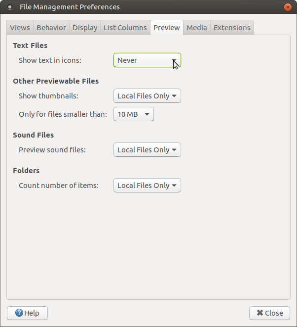

By the way I accidentally solved this.
When I connect to a remote machine, caja would show file icons. Then I realized that it should've been the opposite because I selected "Local Files Only" in "Show Text Icons" menu.
Then I selected "Always" and it wouldn't show icons on remote machine as well. Then finally i selected "Never" and now i can see file icons on both remote and local machines.
In short I misunderstood this setting. I think the original issue is this: https://github.com/mate-desktop/caja/issues/1047
But my question was not that, I didn't care about seeing file content in icons, I just wanted to discriminate different file types in my folder. So it's achieved by this setting.
Then i can see file icons.

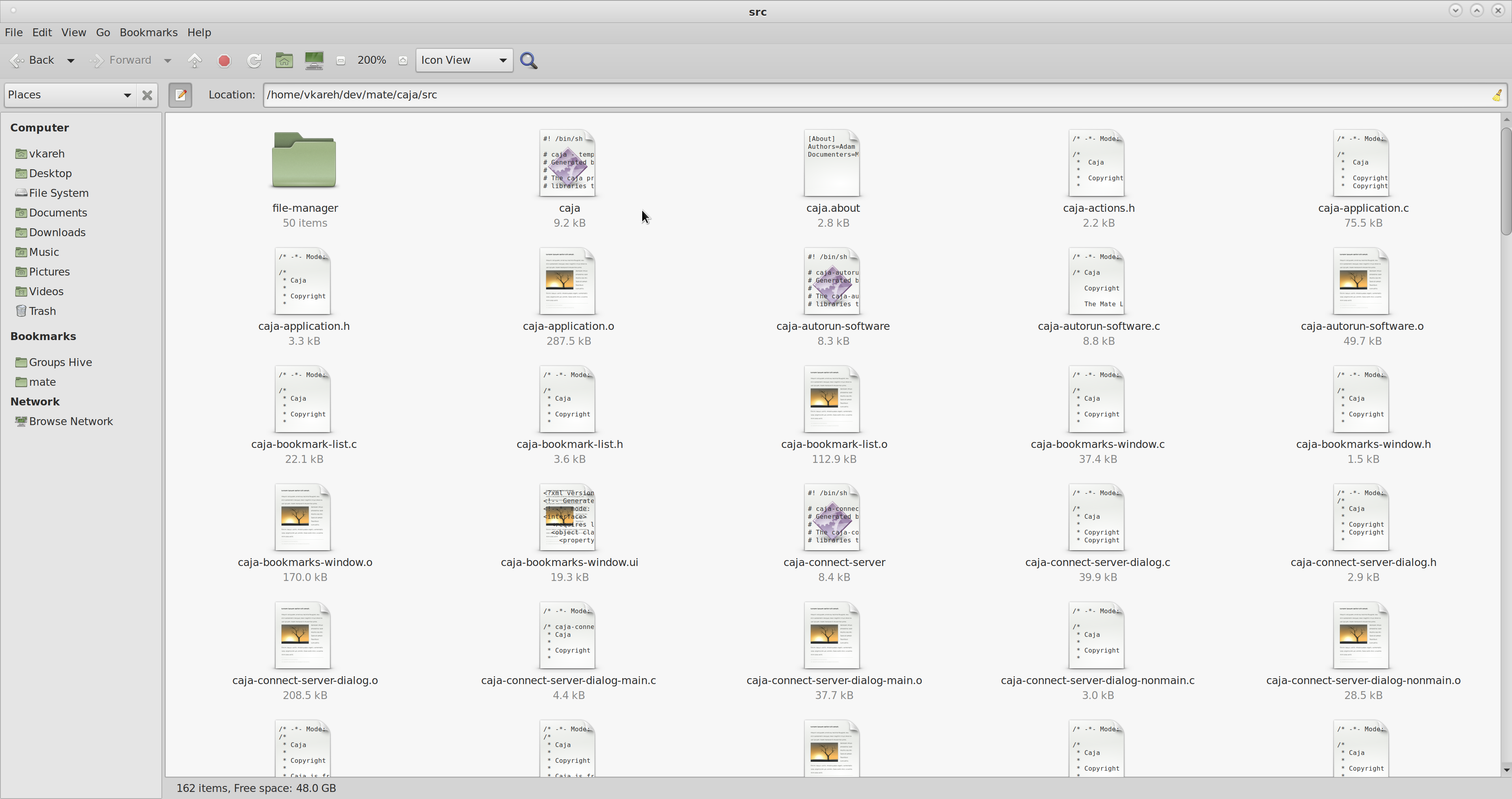

Hmmm... So, the icons you see when selecting Never are not actually the preview. They are the default icons. When you set the preview to Always, it should render the actual text of the file as part of the icon. That's the part that broke and hence why the icons are blank.
I've looked into this and the issue goes back to GTK removing some GtkIconInfo functions that we used for this. The solution is to reimplement these functions inside MATE, but it's quite a bit of code that the GTK team removed. I've so far implemented some of the code inside caja, but I'm gonna need some more time before we get actual file previews, then refractor the whole thing and move it to the core mate-desktop libs.
Unfortunately this won't be in the upcoming version of MATE, since we just did a feature freeze a few weeks ago.
