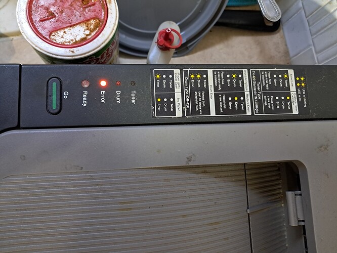

Can I find the cause of the error for a Brother printer?

OK I will have another go. maybe its not a paper jam after all.
The machine does not print?
If you turn off the device, remove the paper tray and turn it back on are the status led's any different?
If you put the paper tray back in, do you then get the error?
Many of the youtube video's about this device are paper lifting errors.
A printer needs to lift the paper once the tray is inserted otherwise you would snap off the rollers when you fill the tray with paper.
It does this one of two ways, a spring inside the paper tray that gets released when you insert the tray or a cog / gear on the tray that is driven by a motor.
If this is the problem, this video may help.
I would assume the PE sensor mentioned earlier means "paper empty" however being unfamiliar with this device I can only assume.

I blew it out with air. I will set it aside for a while.
The guy in the video says, "I am not going to lie to you, it ain't easy...

If you haven't followed my advice earlier about removing the paper tray to find when the error occurs and if it does, you may be chasing the wrong fault.

SAME message with paper tray in or out.

I feel like it is a hardware issue.

It is, unplug the USB cable and I bet the error is still displayed and the fact the status leds remain the same whether the paper tray is installed or not indicates there is a problem with the printer.
Looking at the other leds its not just run out of toner or something as basic as that? the drum looks like it needs attention.
If the printer was working, with the device in ready state you can press the go button several times to print a config test page, but fixit7 surely knows that already.

I lightly cleaned the rollers and drum.
I recently refilled the toner and bought a new cap.
That video someone posted I think has the answer, but my motor skills are not what they used to be.
I can get one side loose, but trying to get the other side loose would probably end in breakage.
I think the printer is not picking up the paper.
Take a look at the video I posted, I think it's a bit clearer of what you have to.do.
To get that left cover off, use flat blade screwdrivers or coins to lift the cover away from the tabs, it may take a bit of persuasion.
Once the cover is off, turn the printer on without the paper tray in, insert the tray, and you will find out if it's a paper lifting problem.

The pic is where I am so far.

I got the panel off.
