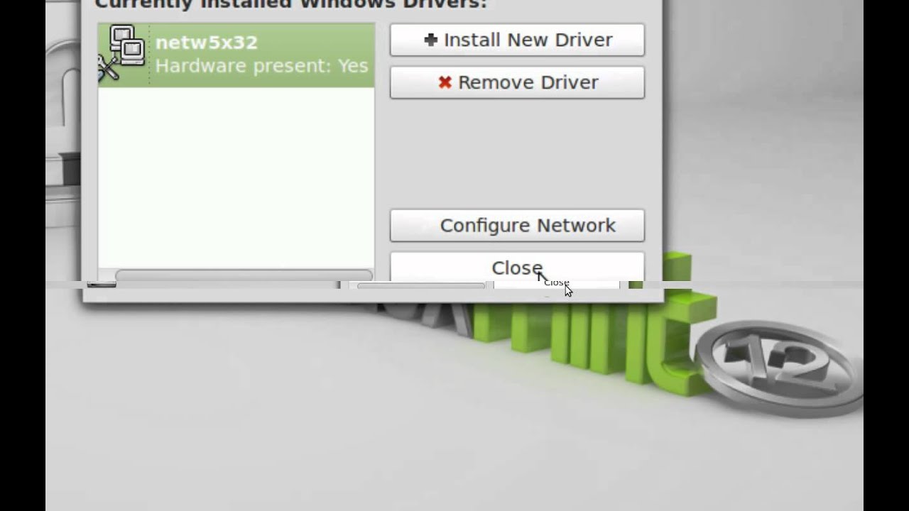

I tried the windows wireless tool, that didn’t work for me. Nothing is showing in additional drivers.
