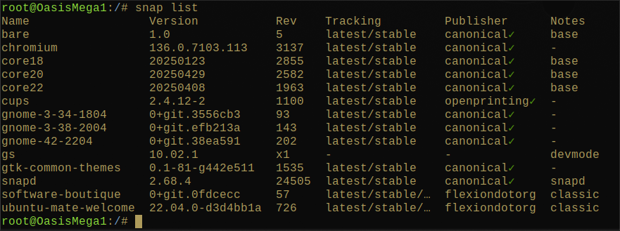

Confusion regarding presence of snap packages on UM 22.04
I just entered
snap list
and discovered some unexpected snap packages:
First surprise:
If GNOME is not required for UM, why is that installed, because I never requested that ???
Second surprise:
I installed CUPS as a Debian package. How did it become a SNAP package
  • without my being warned of the switch-over,
or
  • without first getting me to confirm to proceed, before doing the switch ???
Also, since the upstream is Debian, can someone confirm that Ubuntu made the conversion to SNAP and "foisted" that on us?
Third surprise:
Same questions about the 3 instances of "core??":
  • why no heads up?
  • why no request to confirm?
Is there any way to reverse the "core" snaps, or am I stuck with those?
Lastly ...
Is there any way to "force" an end-user install preference as Debian (non-SNAP) for ALL packages required?
I noticed the same thing recently; no real warning once a transition is made to snap (there possibly is some output from whichever sudo apt update corresponded with the changeover).
The old core snaps tend to stick around even after all installed packages have moved on to other cores.
You can look up which snaps are dependent on others via snap connections. However, this won't indicate which base a snap uses (e.g. chromium is based on core22). The base for a snap can be seen with snap info --verbose.
The firefox snap package uses a number of packages, on 24.10 (oracular) it requires (due connections)
snap:core22
snap:gnome-42-2204
snap:gtk-common-themes
so a 24.10 system which has only firefox snap package added will require those so firefox can run.
A quick look and 22.04 firefox has those same requirements as well.

You can look which packages are connecting to the gnome snaps (i.e. are dependent upon the gnome snap):
user@home:~$ snap connections | grep gnome-
content[gnome-42-2204]   firefox:gnome-42-2204                            gnome-42-2204:gnome-42-2204     -
content[gnome-42-2204]   firmware-updater:gnome-42-2204                   gnome-42-2204:gnome-42-2204     -
content[gnome-42-2204]   snap-store:gnome-42-2204                         gnome-42-2204:gnome-42-2204     -
content[gnome-42-2204]   snapd-desktop-integration:gnome-42-2204          gnome-42-2204:gnome-42-2204     -
The second column essentially says that on my system, firefox, firmware-updater, snap-store, and snapd-desktop-integration all depend on gnome-42-2204.
You can do that for any snap you want to remove. I'd also check the base snap for each installed snap, something like this should provide a list:
snap list | \
    sed -r 's/^([^[:space:]]+)[[:space:]]+[0-9].*/\1/g' | \
    xargs snap info --verbose | \
    grep '^base:'
Which gives me output:
base:         core22
base:         core22
base:         core22
base:         core22
base:         core22
base:         bare
base:         core22
base:         core22
So if core20 was sitting on my system (which it was a couple of weeks back), I could safely remove it (snap remove core20) because it did not come up in the connections, nor was it the base for any of my installed snaps.

Is there a way to identify which core is used by each of the installed snap packages?
If so, is there a way to "force" those packages to recognize and use the latest version of the core?
I don't think you can change the base for a snap, but I could be wrong.
