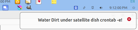

It should have showed this
Notify_Send_Message
