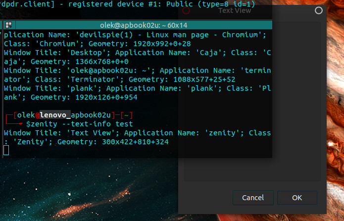

I achieved it my side assuming that the problematic software is Zenity :
with a syntax made for Zenity only :
(if (is (window_class) "Zenity") (below))
