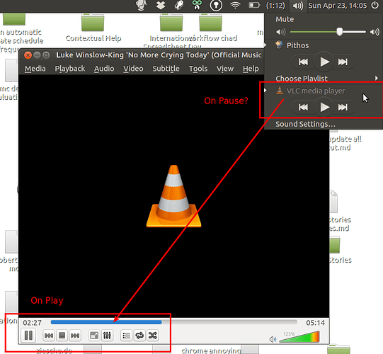

Despite VLC playing, the sound indicator does not properly reflect this state as shown in the screenshot.
Does someone know how to resolve this problem?

Dear all,
Thank you!
Robert

I think VLC is the culprit here, not the sound indicator. Indeed Clementine is not affected by this issue.
