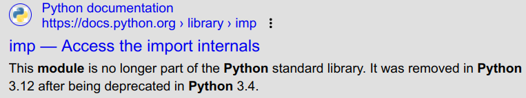

I keep running into issues with it. Would appreciate any assistance. Thanks!

ModuleNotFoundError: No module named 'imp'
