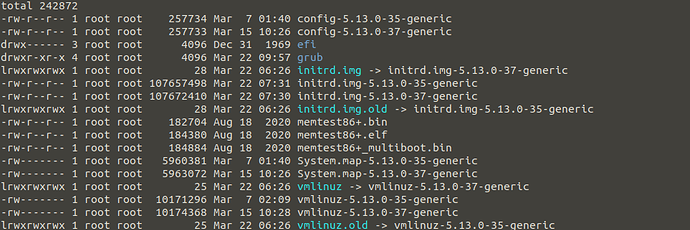

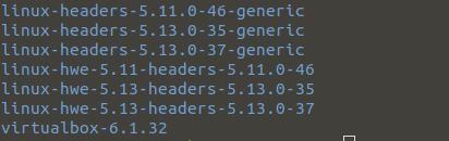

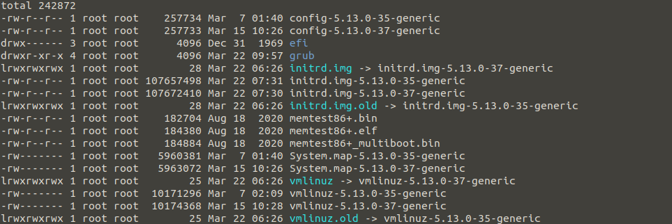

can you paste ls -l /boot ... also, ls -l /usr/src/
Screenshot at 2022-03-25 09-14-49
Reboot and in GRUB menu select the 35 kernel or point vmlinuz to 35, update-grub, and reboot. See if any of those kernels enable your Ethernet (Wired connection 1).
