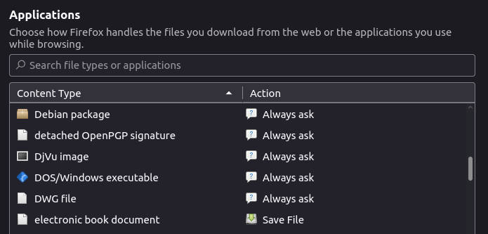

Maybe also review your settings in this section:
