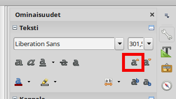

You can increase font size past the dropdown's maximum value by using the "Increase font size" button marked with a red square in the screenshot below (taken from LibreOffice Draw, version 5.3.1.2).
Thank You so much, it works fine. I don’t use Draw programs much, as is evident.
