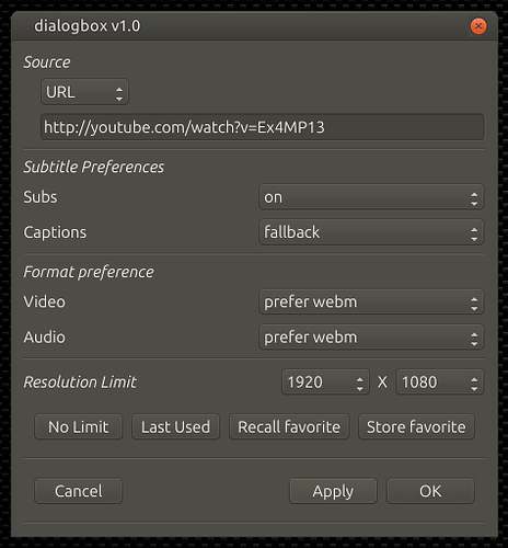

Here is an example for a frontend that I cobbled together in bash and it works like a dream :slight_smile:
I’ve used yad and zenity quite a bit and have no problems with them. From your screenshot, I can’t tell what kind of dialog is being thrown. It would seem you are embedding a YouTube video, but why do you need a dialog for that? Where are the controls (buttons) and options?
Looks like a movie player with option to use/ignore a subtitle file.
For simple things it is enough, but the layout you see in my example can not be done in Yad.
Nor can it do any intermediate output without exiting first (which can be quite inconvenient)
I streched the possibilities of yad to the limit when I made a kind of ‘shoppinglist’ app. It ended up with two minor inconveniences that I could not work around because of this.

Since it’s no longer available, I thought that I could have a go at it just to see if it was possible in ‘dialogbox’ (also tried in yad but making a reasonable practical layout was impossible)
The options are right in front of you, there will be some more.
Controls are not needed, it’s not a mediaplayer :slight_smile:
Almost correct. :slight_smile:
It is an attempt to create a frontend for yt-dlp , nothing serious though, just to see how far I can get with ‘dialogbox’.

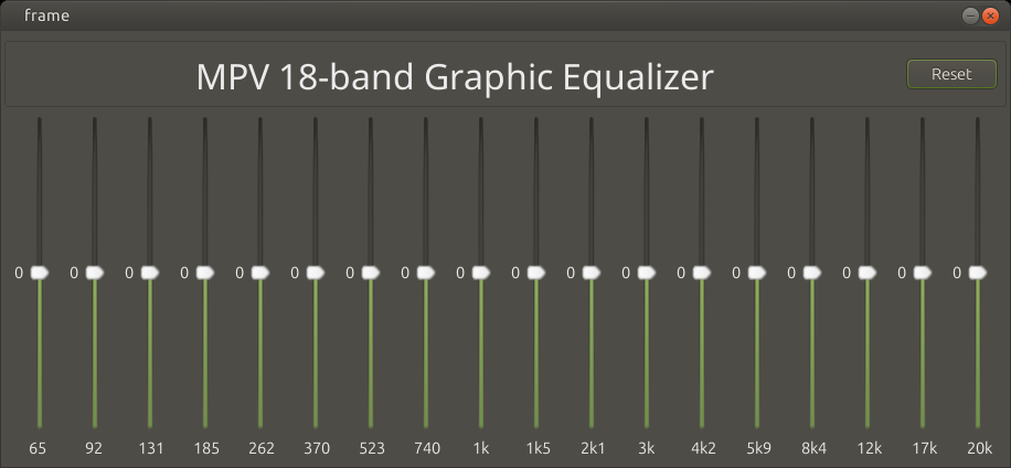

If I have to go with an intermediate layer then I would use WxWidgets which has a GUI Designer and a code generator. I've used that several years ago to create a EQ frontend for MPV:
EDIT: oops, the name of the screenshot is a bit, let's say, misleading. Sorry :slight_smile:
