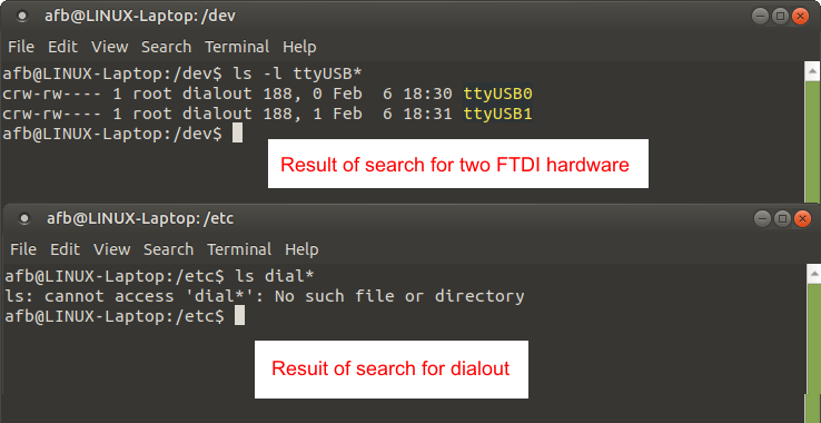

I finally had time to try your suggestions and ran into a difficulty. I found out that there is no dialout group in etc directory on my system. I have attached two screenshots one shows that the two hardware devices can be found in the dev directory.
Here is the screenshot:
As the second screenshot shows no dialout directory has yet been established.
Is there still some obscure command line input which has been missed in the preparation of the USB port availability to the O.S.?
Keeping in mind that this is a new virgin setup of MATE, is there a suite of setup procedures I have yet to install? What I am learning about MATE is that while some things are set up automatically after running install scripts for apps, the reality is that there are many more things that are not.
I am reading up on chmod to determine the right syntax to use when changing permissions. I remember some of this stuff from my experience with UNIX from a couple decades ago but the exact syntax escapes me now.

What @pavlos_kairis wrote in his earlier post, in this topic, is that "(...) if you look in /etc/group you will find a dialout group. (...)". What Pavlos meant by that, is that if you look in the file called group that is located inside the /etc directory, you will find that, among the many lines of that file, there is a line for a group called dialout
So, if you type the following command now, you will probably find that the user afb is NOT (yet) part of the dialout group:
groups afb
To add your user afb to that dialout group (as one of the secondary groups of the user afb) please type the following command:
sudo usermod -a -G dialout afb
After you do that, if you then type again the following command, you will most likely find that the dialout group is now one of the groups associated with the afb user:
 groups afb
I hope this helps. Please, keep us posted :slight_smile:
UPDATE (7th February 2025): I've edited this post of mine to add the missing sudo in the beginning of the usermod command. Thanks for the alert, @pavlos_kairis :slight_smile:
thank you Ric for helping out. Two points:
  • you need sudo usermod since it writes to /etc/group
  • after the change you need to logout/login.

This did indeed work and dialout is now listed as associated with afb.

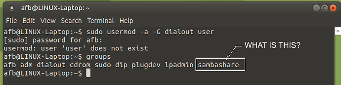

pavlos,
I though I might show you the result of my typing the "groups" command. I have a question about one item on the list. Mainly do you know what it is and is it "Friendly"?
Whenever I see the word "share" I want to know what is being shared and with whom.
sambashare:
share files with the local network. It is friendly.
