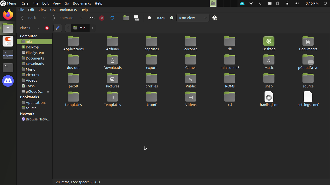

In December, I upgraded from 24.04 to 24.10. From 22.04, I have used every interim release and have had no issues so far, until this update. It took a lot of time to restore the ability to actually reach the desktop. I mostly got it working again but one issue that remains is that when the global application menu is enabled, applications still display their own menus. If I disable and then re-enable the global menu, I'll get maybe 30 seconds of it working properly before the double menus start showing up again. Does anyone know how to fix this?

Here is Caja showing the issue.
Screenshots don't seem to work while the option is displayed, but it was just right clicking the global menu and removing it from the panel, and then right clicking the panel and add to panel, then selecting global application menu. On all previous versions I have used, the presence of the global menu in the panel would also toggle whether applications showed their own menus.
