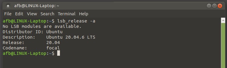

A minute ago in order to confirm what version I now have, I ran lsb_release -a (which came from Google's AI search result.) I'm thinking AI is not very "I" I got this:
As you can see it did not upgrade to 24.04.6 LTS
I have to think there must be another way to upgrade. I should tell you I don't have enough experience with Linux yet to go searching for all sorts of component/dependency files and compiling and building them, etc. I am presently relying on package extracting and running automation. Somehow I managed to upgrade from 16 to 20 a few weeks ago so I don't see why this isn't proceeding as expected.
Perhaps you can spot the impediment from the screen capture and offer a further suggestion.

Yes! 20.04 predates the release of GTK 4. It's not available as a package (for 20.04 "focal").
You'll probably want to get your system up-to-date first. Check in Software & UpdatesUpdates tab that you have "Notify me of a new Ubuntu version" set to "For long term release only". Then you can run:
sudo do-release-upgrade
Be sure to backup everything first, just in case. That'll get you to 22.04 LTS. You could jump again to 24.04 LTS by repeating the step. It may take an hour or more to complete.

@lah7 explained how to upgrade your OS version in place. apt update refreshes repository metadata and apt upgrade installs latest updates and patches for the current OS version only.

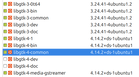

The latest UM LTS version is 24.04.2
As far as I can see, it has as GTK3, as GTK4 libraries installed by default
