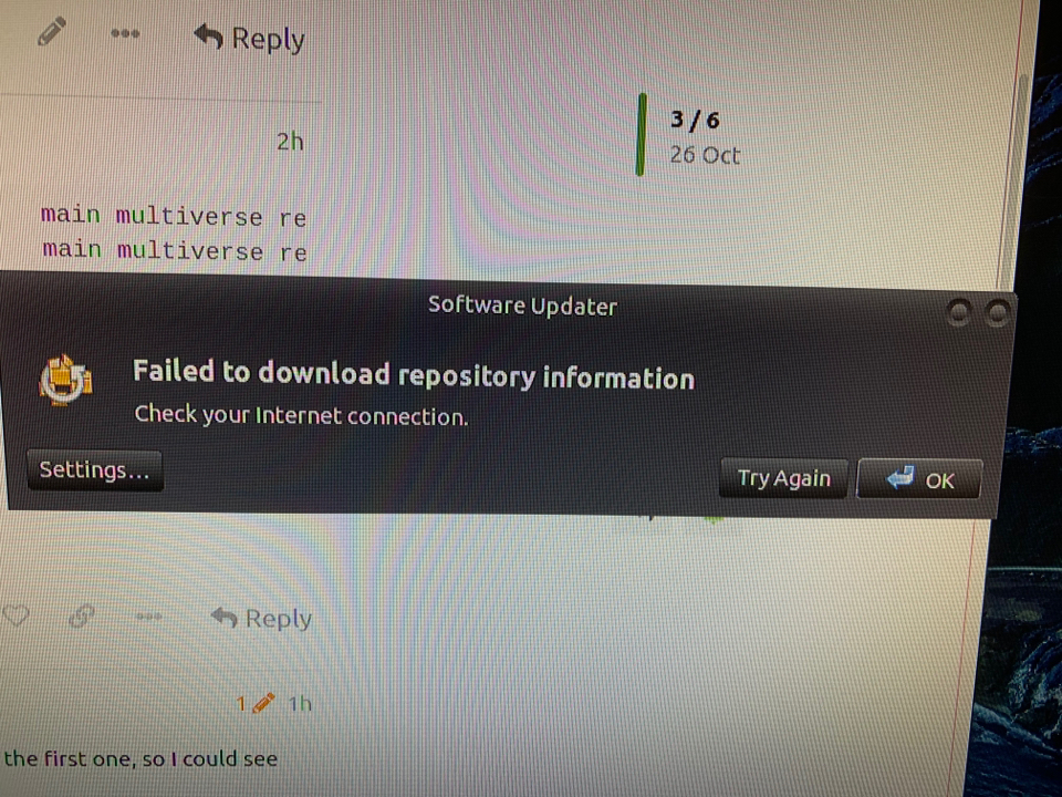

HELP Software Update got screwed up Raspberry Pi 4B
Every time I try to use software updater, I get an error failed to download repository information. I think I might have screwed up the list. How do I go back to original sources?

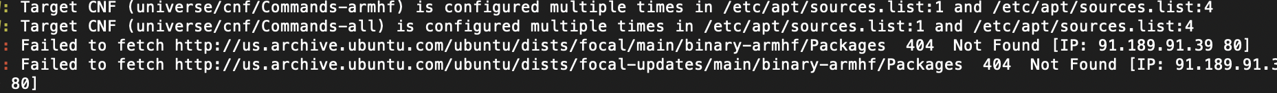

There are many erros file to large. Duplicate fetching etc.

My /etc/apt/sources.list on a Pi4B with 20.04 looks like:
deb http://ports.ubuntu.com/ubuntu-ports/ focal main restricted universe multiverse
deb http://ports.ubuntu.com/ubuntu-ports/ focal-security main restricted universe multiverse
deb http://ports.ubuntu.com/ubuntu-ports/ focal-updates main restricted universe multiverse
