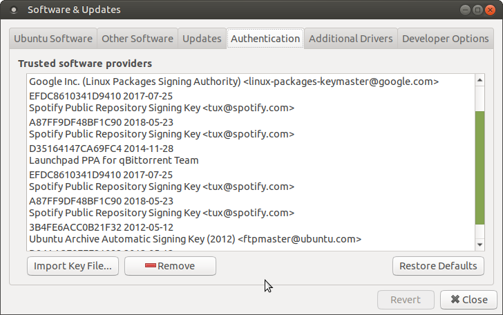

But when I checked on Software Updates > Authentication, there's now 4 spotify entries. And they can't be removed.
Is it safe to just leave them be?

you can remove the expired keys by taking the last 8 digits (no space), example
sudo apt-key del 48BF1C90
I don’t mind if the keys are there.
Thanks. That removed they key.
