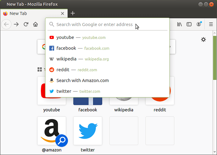

That's a Firefox 79.0 window from the Ubuntu MATE 20.04 live session.
This thing is missing.
I am referring to the search box next to address box. I want to this box/window.
