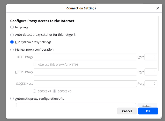

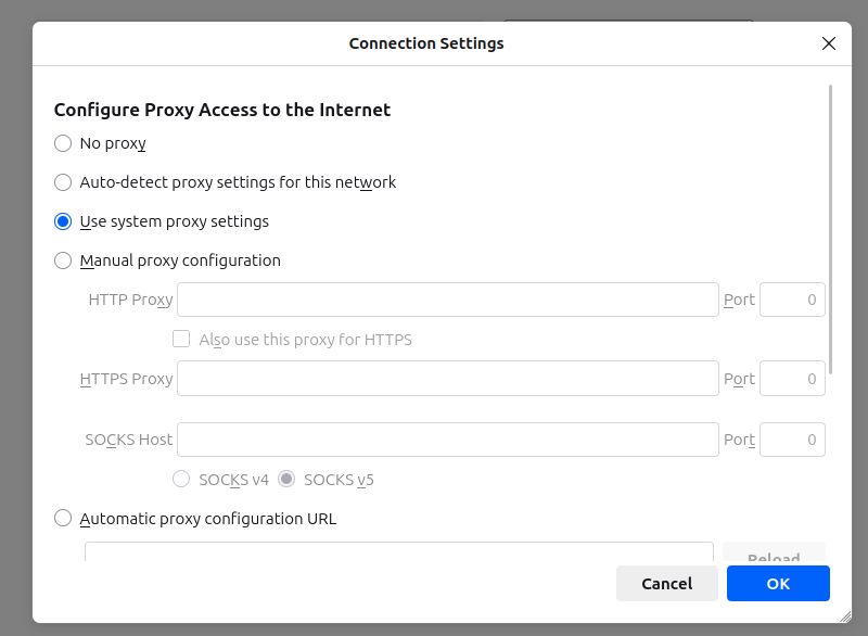

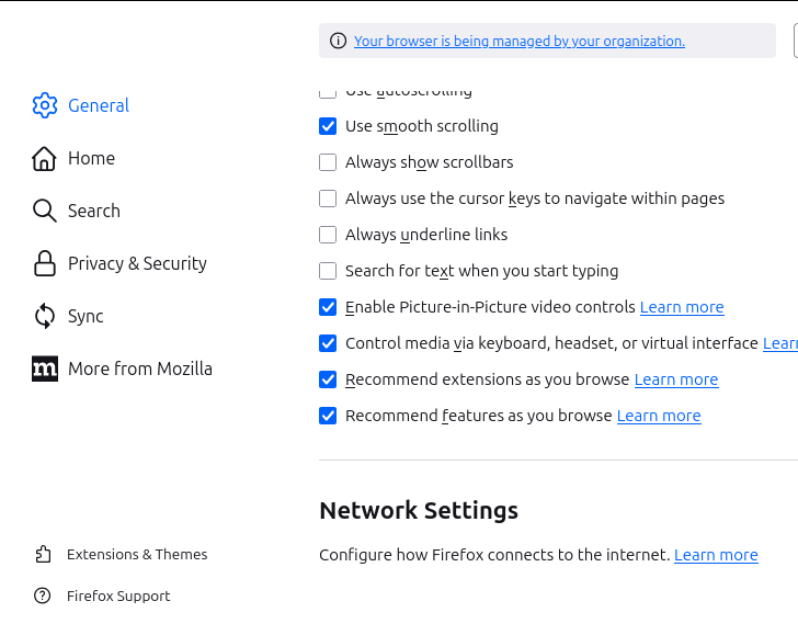

Did you mess with your settings>Network Settings>Connection Settings?

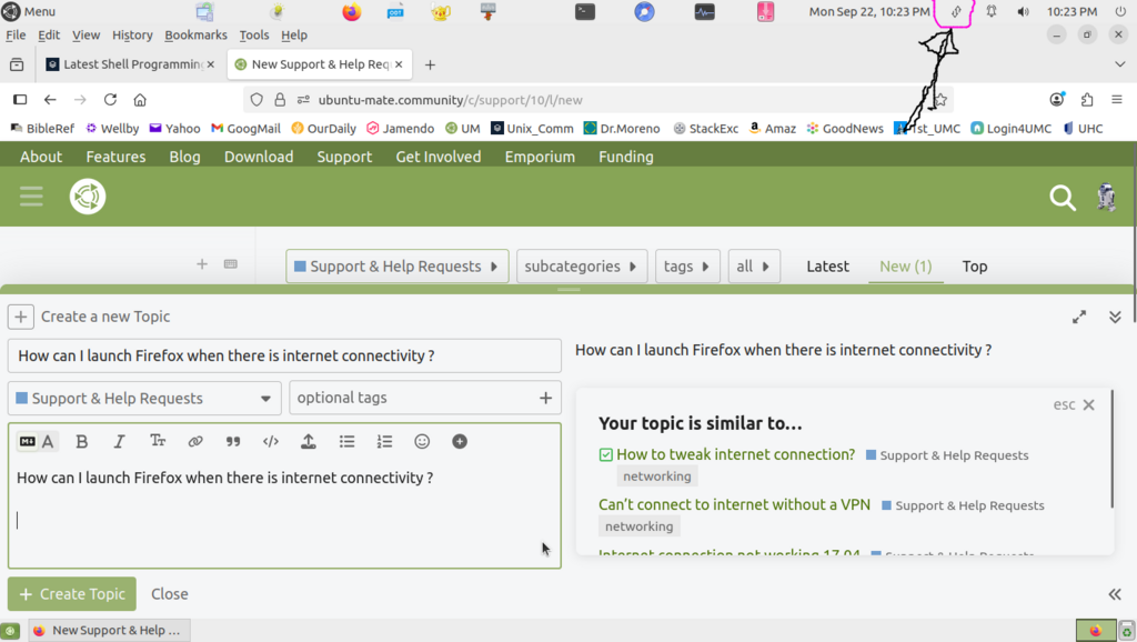

I use a different Icon set, what are you trying to show us, the network is connected or the network is down with your drawing to your top panel?
This checks if there is an internet connection.
I would like it to start Firefox.
