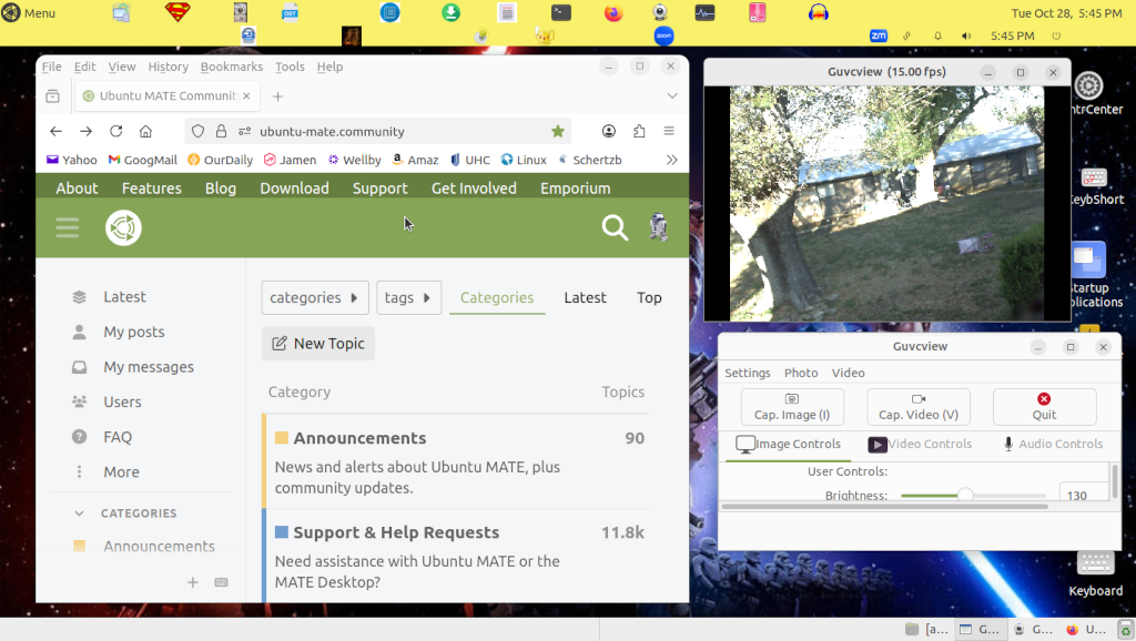

How can I make it harder to close these windows?
I looked at Gnome Tweaks, but could not find anything.
I keep accidentally closing them.
