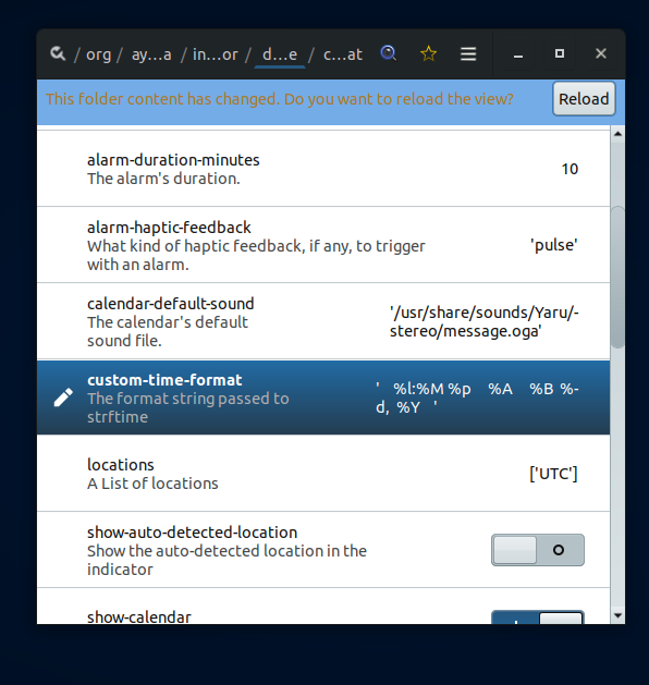

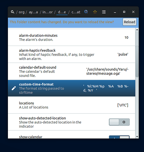

using dconf-editor, go to /com/canonical/indicator/datetime and enable show-date.
In 20.10 the location changed. Using dconf-editor, go to /org/ayatana/indicator/datetime and enable show-date.
Thanks to all! I did it with answer #1, because I've Ubuntu Mate 20.04.
