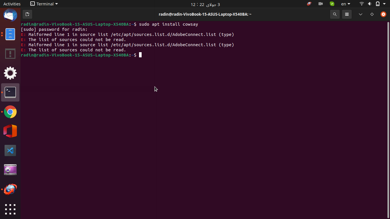

Malformed entry 1 in list file /etc/apt/sources.list.d/anydesk-stable.list
How i can solve this.
can you post the first line?
Can you please solve my problem? I will be grateful. I am not fluent in English. Excuse me, if I do not write correctly, I am Iranian.
I am in a hurry. Can you answer me as soon as possible? I only migrated from Windows to Ubuntu a month ago.
Please run the terminal command:
cat /etc/apt/sources.list.d/AdobeConnect.list
Copy the output of that command to the clipboard, paste it into a post here, select the post text you just pasted, and click the little </>
icon above the post editor panel.
This will help us figure out what's the problem.

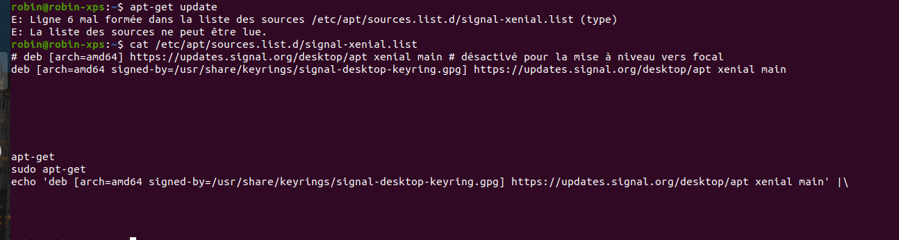

Hi there,
Here is a similar problem, I guess.
I can't figure out the problem and, of course, how to solve it. I 'll be very grateful at the one who can help me. Thanks!
Geez. Is it true that there is a boatload of newlines and apt-get
and echo
commands in that /etc/apt/sources.list.d/signal-xenial.list
file?
If so, open the file in a text editor, like this:
sudo pluma /etc/apt/sources.list.d/signal-xenial.list
Delete everything, everything from that file except for the first two lines, the ones that read # deb [...]
and deb [...]
. Then save the file, close the text editor, and try another sudo apt-get update
Here's a link how to install Signal Messenger on Linux Mint (similar to Ubuntu Mate).
See steps 1-4
Thanks, guys! I'm new to ubuntu and I can't believe how fast I got valuable answers. Amazing!
I'm still in trouble though. I can't open pluma.
Should I try another editor?
Oh! I'll bet you're using stock Ubuntu, and not Ubuntu MATE, is that correct?
If so, replace pluma
with gedit
Indeed! Sorry, I didn't give any details.
It worked perfectly, thank you so much!
