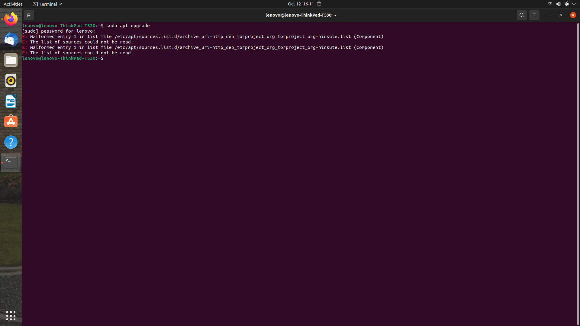

hello my ubuntu is displaying the following error. Malformed entry 1 in list file /etc/apt/sources.list.d/archive_uri-http_deb_torproject_org_torproject_org-hirsute.list (Component)
E: The list of sources could not be read. i tried to install tor then i removed it from software and updates.now i cannot update
Welcome, @infinite_joker. :wave: :ubuntu_mate:
The output of that command points you to a specific file where the error is located.
Please run the following command to print the contents of that file, complete with line numbers:
nl '/etc/apt/sources.list.d/archive_uri-http_deb_torproject_org_torproject_org-hirsute.list'
Copy the output of that command into a post here. Also, please then highlight the text you just pasted, and click the </> button above the post editor's text area. (By clicking the </> button, it makes the text easier for me to read.) Chances are, there's just a missing whitespace or something in the file, and I'll tell you how to change the file after you've shown me its contents.
Thanks so much I managed to remove the source from sources and updates and then I was able to run apt update

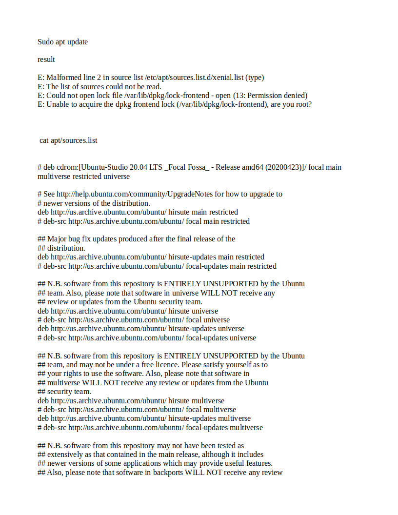

As i am new here, i can only post 1 line of text.
Hi chad, welcome to the community :slight_smile:
Let's tackle the errors one by one:
E: Malformed line 2 in source list /etc/apt/sources.list.d/xenial.list
The second line in your /etc/apt/sources.list.d/xenial.list file contains an error. Please post the contents of that file instead of the contents of /etc/apt/sources.list so that we can check what's wrong with it. :slight_smile:

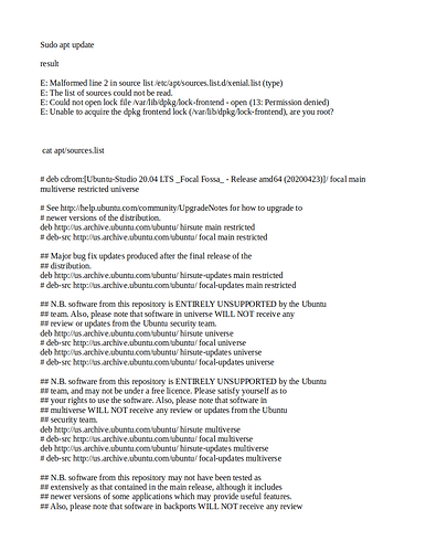

E: Could not open lock file ... (13: Permission denied)
E: Unable to acquire the dpkg frontend lock ... , are you root ?
Ah yes, be aware that Linux based systems are case sensitive:
sudo apt update will work
Sudo apt update won't work
b.t.w. I see that you are running Ubuntu-MATE 21.04 (hirsute) but that the file containing the error is from Ubuntu-MATE 16.04 (xenial). You probably don't need it. :slight_smile:
my /etc/apt/sources.list.d/xenial.list
deb http://archive.ubuntu.com/ubuntu xenial main restricted universe
multiverse
i am running ubuntu studio Ubuntu 20.04.3 LTS
i was using a text program so it capitalized the sudo to Sudo. in terminal i use sudo apt update
multiverse
Hmm...I guess you have some hidden characters in there because if this was all, it would update without problem (I've checked/tested that).
Possibly this file has been edited in a wordprocessor or was constructed on a windows computer (malformed line-endings)
But anyway, that xenial.list file is useless and could potentially create other problems.
It is de default repository from almost 5 years ago ( it is 8 versions older than your current setup). If you could install something from it (which I doubt) it will probably not work anyway because lots of things have changed since then (libraries etc.).
Best to delete the /etc/apt/sources.list.d/xenial.list file altogether.

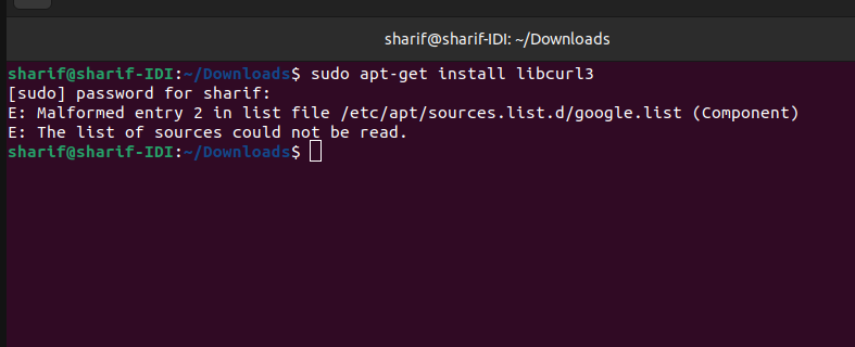

Good morning friends, this is sharif software engineer from openMRS, am facing this issue while am trying out a new linux distribution version 22.04.1 LTS
I have tried out all the above suggestions but its seems the problem is the issue, could this be a problem of linux version.
Thanks alot
Regards
Sharif
cc @pavlos_kairis
Welcome Sharif,
Please follow advice of @gordon :
As has been said above (almost literally) two dozen times...
please print the contents of that file which is causing the error, using this terminal command:
cat /etc/apt/sources.list.d/google.list
Then copy that output from the terminal window into a post here.
Then, highlight the text that you just pasted into your post, and click the </> button right above the post editor text box.
Finally, submit your post.
Once we can read what line 2 (and subsequent lines) of the files contain, then we can help you.

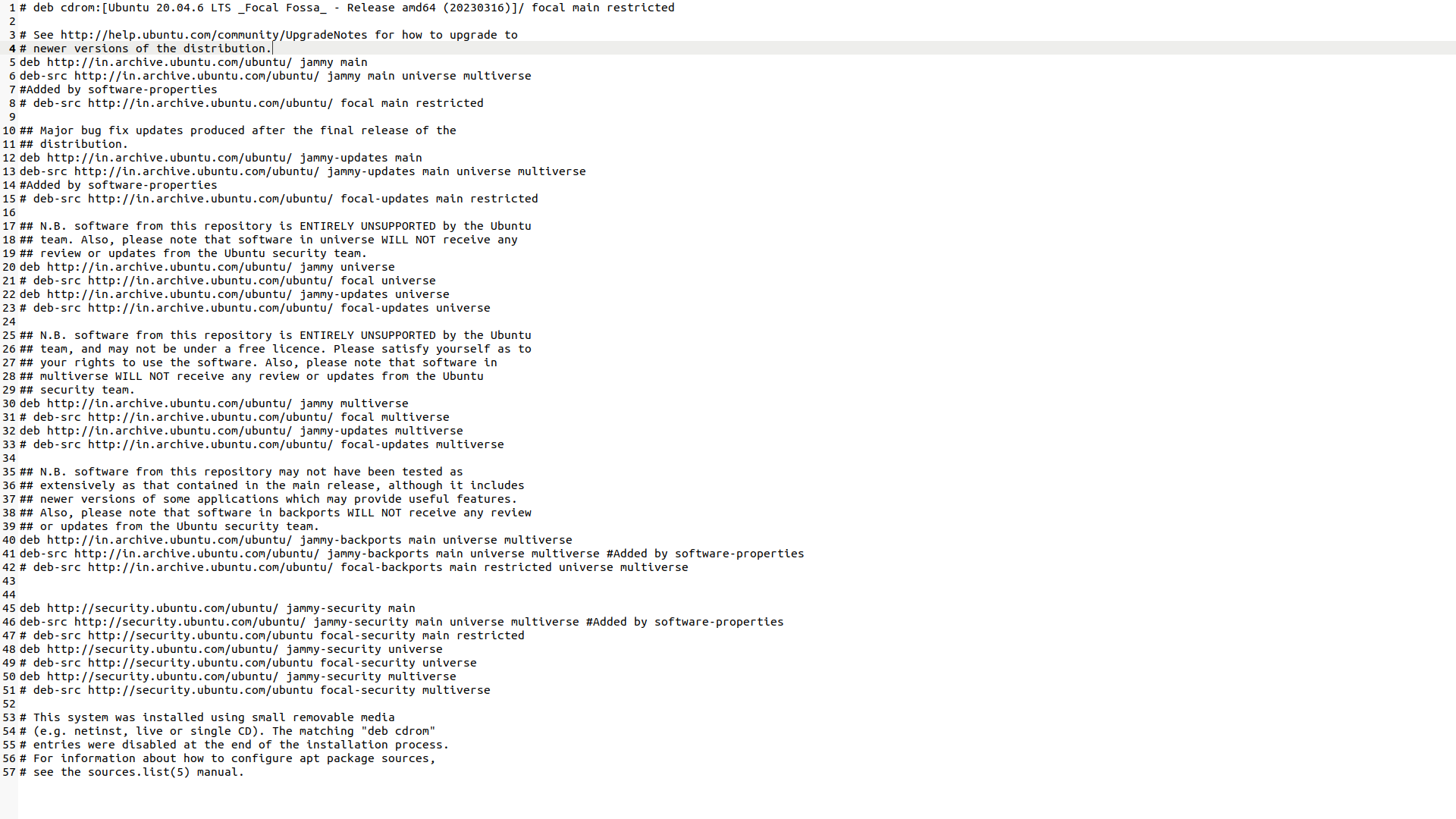

i have this
this error is coming why
Screenshot from 2023-10-28 12-08-13
Welcome @Krish_Mittal_IIT_Man to the community!
you seem to mix focal (20.04) with jammy (22.04) repositories.
paste inxi -r it should be a few lines.
