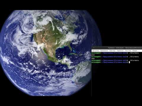

I'm not sure how Marco works, from a quick look I think shaded_back_pixmap is what is drawn on the window when it's transparent.
When you write an application that is suppose to get the screenshot of a rectangle on a screen blur it and copy it to the cairo xlib surface, it works.
But when you need to refresh the image you run into a Schrödinger's cat
The window has to be closed to make another scrot.
I don't know of a way to scrot an area (plane) behind the window with Xlib.
We need a better hacker for this. ![]()
