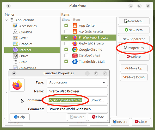

Not sure if this is relevant but I have noticed the "Brisk Menu>Internet" has multiples of the same app listed, 2 firefox, 2 Brave and 2 Syncthing

I am curious about the 2 Firefox entries in Brisk Menu>Internet, one starts firefox 128.6.0esr and the other doesn't do anything.
We have 2 Mate desktops each with two users and were (at the time) identical installs with this one being a daily driver and the other is more mission critical. I managed to get some time with the other computer, it also has 2 versions of ffox listed with both working-launching a ffox window but with different versions 133.0.3 and 128.6.0esr.
I tested the upgrade function on the other computer and it started as expected, I then cancelled the process because at the moment we don't want to risk a mess on that pc.
Not sure what I have done to achieve this, how could I have installed the same browser twice?

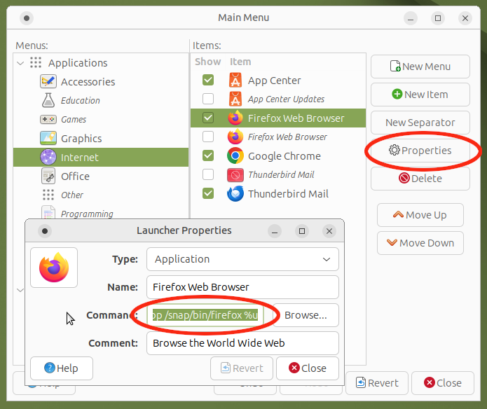

Most likely, you have a .deb version installed from a PPA plus a snap version. Canonical has a proxy .deb package for Firefox in repositories, but one can overwrite it from the PPA.
ls snap just shows the contents of your snap directory. This may be related to the currently installed snaps, or some remnants from previous installations, or something else.

How did you come to this conclusion? Do you have duplicate launchers in your menu or what?
I was trying to avoid a reinstall but I think a clean install might be the best option.
Yes I have two launchers for Software Boutique, firefox and Brave. On this desktop only one of each launcher works but on the other desktop both of the Brave and firefox launchers work.

I doubt it. There is no reason to overanalyze the situation at the moment. You can inspect your duplicate launchers using the 'Main Menu' tool. You'll see the command it tries to execute.
Example:
  1. You have a PPA an apt repository for the Brave browser added to your system. Why? It was added for a reason. You could have installed the Brave browser as a .deb package from this PPA apt repository.
  2. You probably have the Brave browser .snap installed as well, as you said before.
These things can coexist. Two separate packages can give you two launchers.
