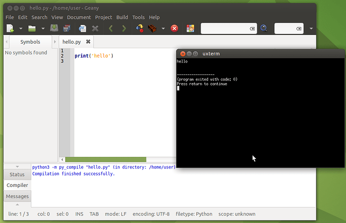

I started geany, went to Build > Set Build Commands and changed python to python3 (in two places, I dont have python but I have python3). The I wrote this python code, print('hello'), clicked on Build>compile, then Build>execute and I got output (uxterm).
You can do the same with C, C++, or any other language you work with. Hope this helps.
