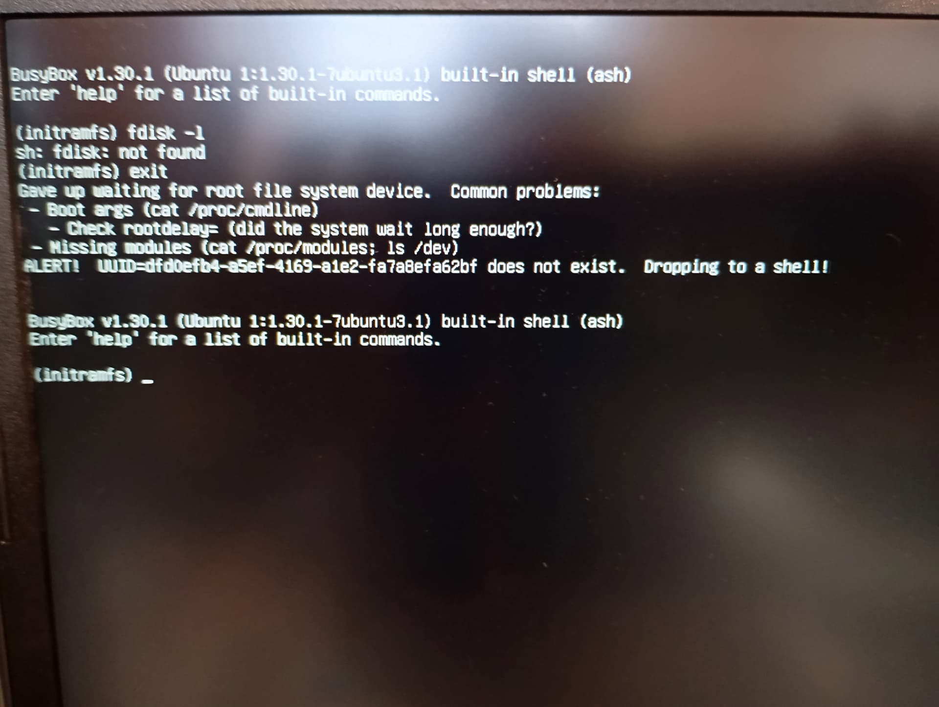

Updating to the latest driver (580) made things worse. Now I cannot access kernel 6.8.0-87-generic at all. (see picture)

There is one line that worries me a bit:
ALERT! UUID=dfd0efb4-a5ef-4169-a1e2-fa7a8efa62bf does not exist.
Which generally means: it can not find your harddisk, or more specific, your root/boot partition.
The odd thing is that I can boot from Kernel 6.8.0-85, but not 6.8.0-87
If you compare that UUID to the one reported in 6.8.0-85, is it the same as for the failed 6.8..0-87 boot?

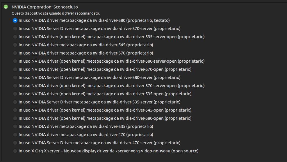

Or it’s really because NVIDIA removed the 550 drivers (and only those, see picture) from the list :sweat_smile:
