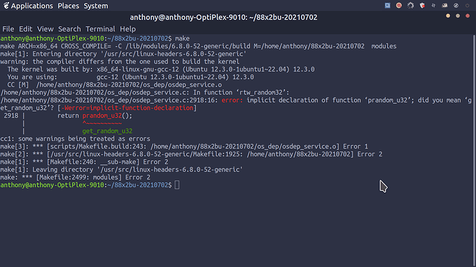

Hi. The log mentions this error: Skipping BTF generation for /var/lib/dkms/rtl88x2bu/5.13.1/build/88x2bu.ko due to unavailability of vmlinux. I have UM 20.04.
That log is from a successful build on your earlier kernel (5.15). The hint is at this line:
make[1]: Leaving directory '/usr/src/linux-headers-5.15.0-133-generic'
According to the pastebin (and from my understanding) skipping BTF generation is not an error.
We'd need the log from when you try to install on 6.8.x.
I thought it was wrong, but between trying the three drivers mentioned to get wifi for 6.08, got a little loopy. Sorry.
/var/lib/dkms/rtl88x2bu/5.13.1/build/make.log As you can see from the screenshot, the folder "build" is not present. I have Jammy--earlier I said I had the previous release. Sorry about that. As an aside, I was wondering if when I click the reply button in your post are you the only one that sees it? I don't want to keep others that might have ideas from seeing the post.

That looks like it has been fixed in all of the drivers, both the ones I've listed and in the latest version of the one @pavlos_kairis provided.
The contents of your var/lib/dkms/rtl88x2bu look very odd.
Remove that driver using dkms remove rtl88x2bu/5.13.1 -k 6.8.0-52-generic. Remove every driver you've ever tried with dkms remove <insert name here> -k 6.8.0-52-generic (you might need to look at ls /var/lib/dkms/rt* for clues). Get rid of the driver source code in your user folder. Get the latest source code from here: https://github.com/morrownr/88x2bu-20210702/archive/refs/heads/main.zip - try again.
